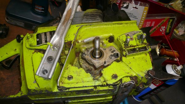

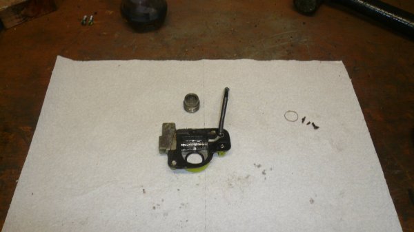

    The oiler quit on me this weekend thought it was all over, parts for these are getting to be unobtainium.
    Figured I stripped out the bevel gear, I've had this saw for thirty years still my favorite.
    So pulled her down today the pump was full of what seemed like hard plastic granules, there was no problem with the screen. I am guessing its just crystalized oil built up over the years. she mostly gets used only on the big rounds. cleaned her out put her all back together. Had to dial back the adjustment it was pumping like an oil well!

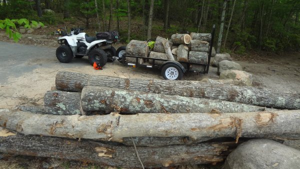

    Doing what she does best, that's why I love this saw never a complaint it just goes thru like butter.
    That's about all the quad can pull in one load.

    "Don't mind the mule , load the wagon "
    Had some junk get in my oil pump too.
    watery , gummy looking stuff,
    Cleaned it out, working fine.
    I pay a little more attention to the oil, oil jug & dirt around the fill cap now.
    + I put it on my annual maintenance list to clean the oil pump

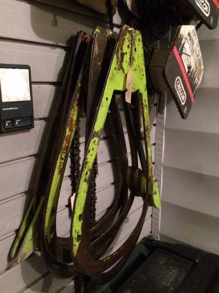

  20. Guido Salvage
    Guido Salvage
    1,735
    4,938
    The heart of the Bluegrass
    These are some of the others I have. I did pick up a NOS one back in the spring.
