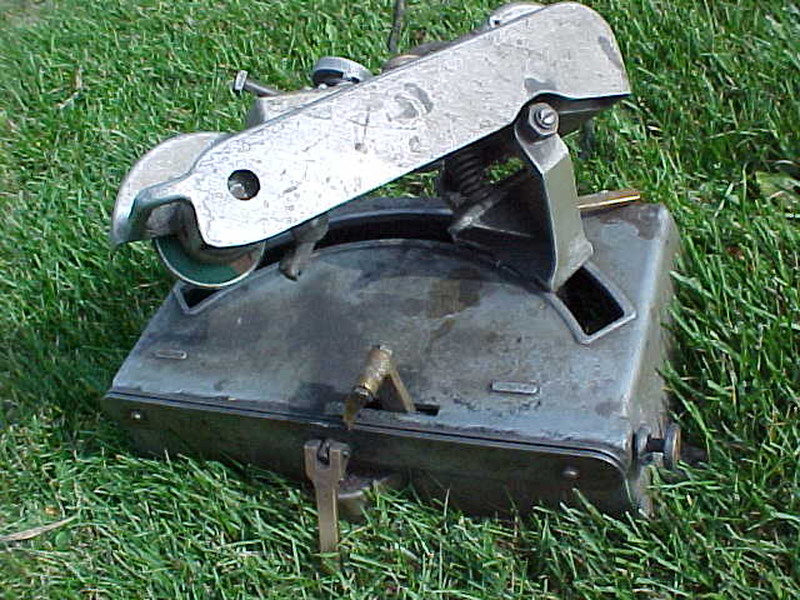

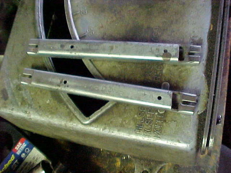

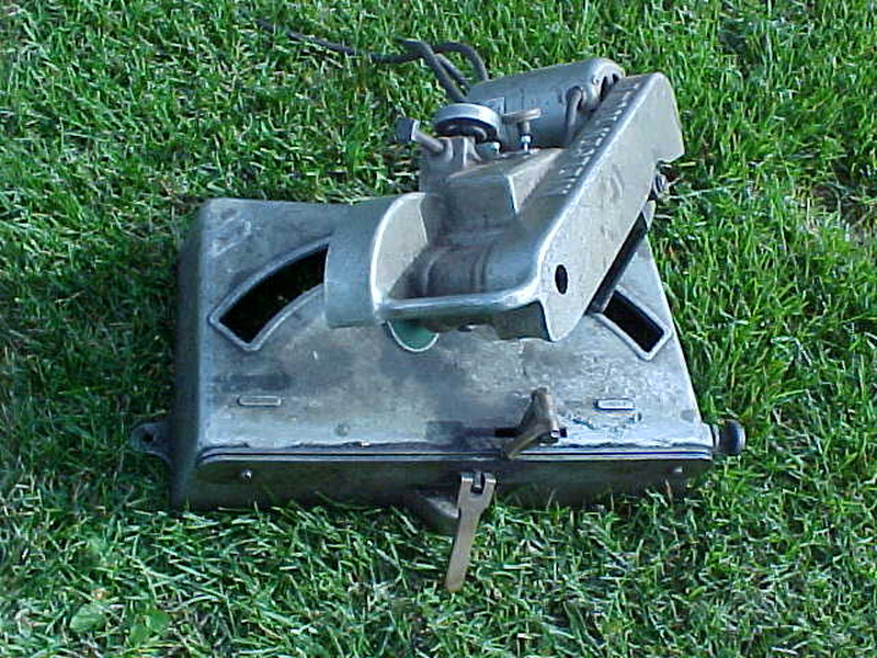

    I still use my grandfathers sharpener he got as being a Homelite dealer in the 1950's Dead simple to use and does a great job for me. Lots of chains done on this one over those years.

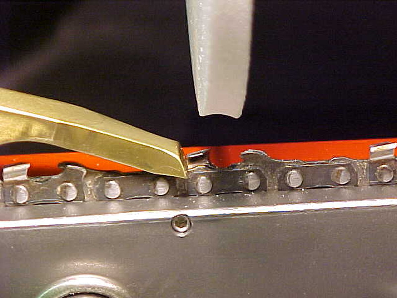

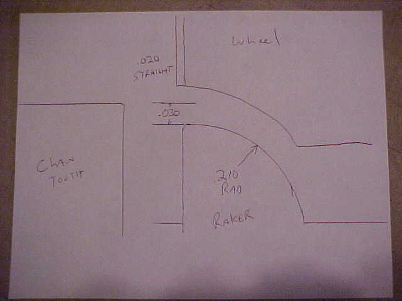

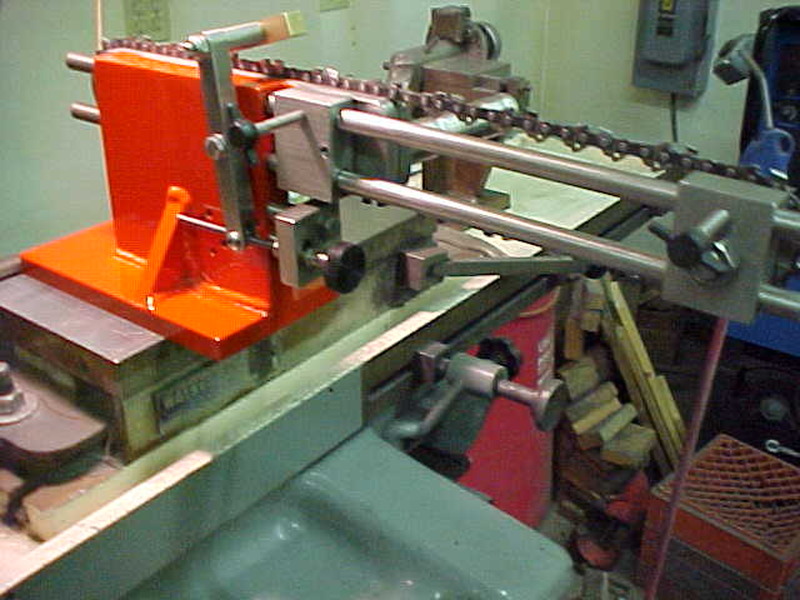

    I'm really liking the contour grinding fixture I made for the rakers as well.
    Makes for a smoother cut and really makes a difference if you are plunge cutting.

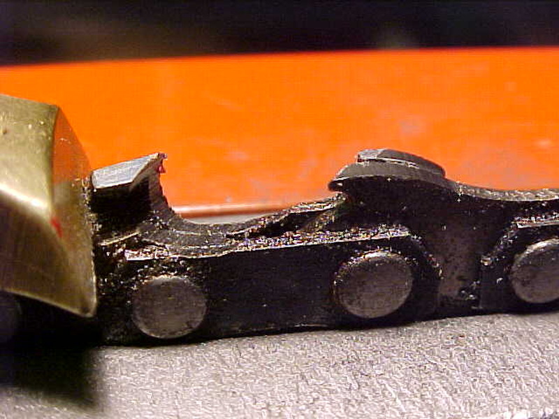

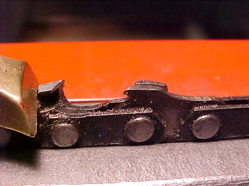

    Before
    After

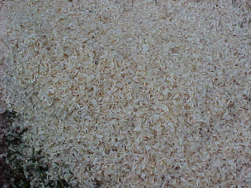

    Results
  6. Jeffrey Svoboda

    With the Picco style chain you can see how the raker won't grab the wood when you're doing a plunge cut with the tip of the bar. Since the centerline of the rivet is the same with the grind. the contour stays the same when the 2 links are.
    You can see what I'm talking about here.
    Measurements for a Stihl RS raker
    Measurements for a Stihl Picco chain raker.
    Never really thought about how it would effect the grab or smoothness of a chain until really thinking about it. Trivial I know but it does come into play why some feel a used chain is not the same as new.
