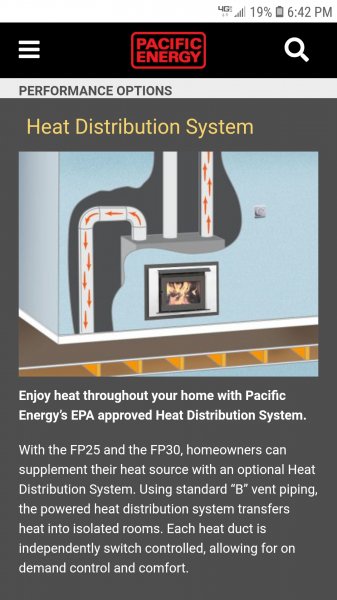

    Im going to be building soon and am faced with the choice of a zero clearance fireplace vs woodstove. Anyone have any insight or been faced with a similar choice? House will be a 1900sq ft ranch. I was originally going with the stove but after thinking about it and looking at some zero clearance's with forced air kits Im leaning that way. Anyone have experience with them and how well do they move heat around?

    Do you mean an insert with a blower?
    “Forced air” is taken more to mean HVAC.
