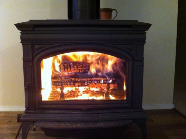

    It's the same as the Cape Cod freestanding stove. It is flush, has a huge glass and an incredible fire! This might be just the ticket.
