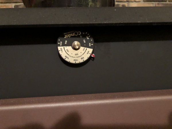

    That cat thermometer you are looking for is a Condar 3-12-1
    The probe goes where the screw is over the door. Read the last page or two of the long thread to see tips on getting it out without haveing to drill like I did.
    With that cat probe you can clearly see it getting hotter while the firebox is dark.

    The cat thermometer sticks a probe in the air flow over the open damper, or when closed, over the edge of the cat. It tells you what you need to know for cat operation and it is clearly color coded to make it easy.
    A couple things. First, getting the screw out may be a challenge. See the other thread for tips. Second, the hole is a bit too big, you can leave it loose or grab a magnet with a center hole to stick it on. Finally, the lip of the lid gets in the way. Lift slightly to insert the probe, and then turn the dial upside down. That will let you see the important range from a distance.
