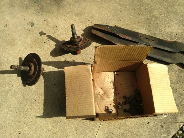

    Well this time one of the spindles was totally shot, so I brought it home to do the work. One spindle had zero bearings in it and the other the bearing came off the shaft and were spinning free and everything just came apart once it was removed.

    There is a hole thats worn/rusted through on the top center of the deck but I had already started painting g and did not want to booster my pretty paint :) so I will do that latter after it either starts peeling from lack of prep, wears or I have just used it a few times. Plus I needed it this weekend to go to the farm thursday and stopped at what I had done so far. I will cut some sheet metal and bang it to shape a bit and weld it on the bottom side or just push some quick steel junk in there ?? I dunno? IMG_20140701_171128_924.jpg IMG_20140701_171019_253.jpg

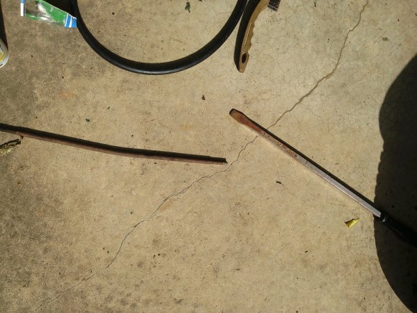

    Nate the original belt had a crack 80% of the way through the belt about every 1/2". It was smaller in diameter from slipping. 2 years ago the adjustment pull y bearings seized and it just burnt through the pulley before I caught it. I just put belt back on. And it was s reached about 1.5" s larger than it should be. Was hard to get tight. For $15 and half the stuff out of the way I might as well go all the way.
    Yea I would say it was not kept up the best. And I dont do as well as I should either but the thing cuts amazing for what it is!! And for only 15hp that kholer engine is strong. Its getting a new tarp or put under the shed this time round!
