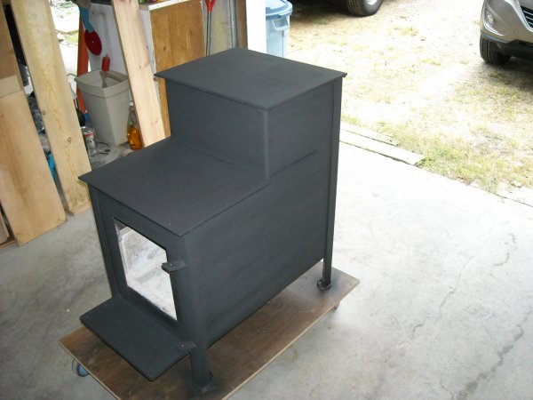

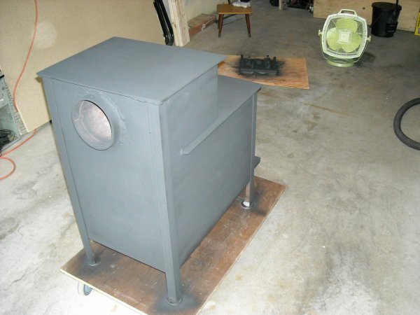

    I had some rust from the Tea pot, so a couple weeks ago I sanded the stove and applied stove polish.
    Had some light surface rust too, but the tea pot did a job on it.
    I did this in the stove room....Shop Vac nozzle next to the sander, windows open and fans going...said to myself, never again....next time I'll do it outside.
    Well, I wasn't happy with the result....So today I pulled the stove into the garage and tried again.
    Used the angle grinder, palm sander and orbital sander. Wire brush on the door.
    This time I used some Rutland stove paint. Ran out of Rutland, had two cans of high heat rustoleum, so I used them too.
    I'm much happier with the result, it's not perfect, but the stove hasn't looked this good in twenty years.
    I'll push it out in the driveway this week and do a couple burns then reinstall it next weekend.
    The wife was telling me to just go get a NC 30....guess I got a week to think about it.
