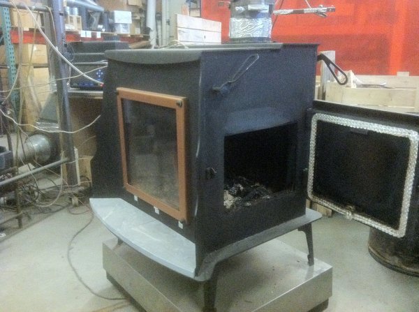

  19. My IS heats my home
    My IS heats my home
    Dec 1, 2013
    7,394
    17,654
    Albany, NH
    Here is a pic of the prototype Franklin in the testing area. It is very basic looking right now, just running numbers with burns and making R&D improvements on the go.
    milleo, wildwest and BridgerBurner like this.
