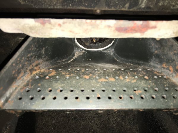

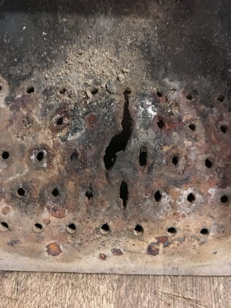

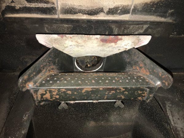

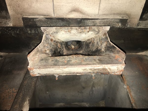

    I noticed that when I was cleaning the P61a Burn pot the other day that the speed bump carbon ash deposit had not lift than usual. After further examination I found the metal pushed up and the holes were torn! The stove works fine but this does not look right!
    I have never seen anything like this before! Have you??
    So would you replace it or try to fix it. It seems hard to fix due to the curvature.
    I threw in another used pot with a new burn pot gasket that is in good shape in the mean time.
    Pics 1-4 Broken Harman Burn Pot
    Pics 5-6 Good used burn pot.

    Weird - never seen that before (KOW - don't want to see it on mine). I would go used if available too.

    The igniter is directly underneath that area of the burn pot(i think). Heard that happened to someone due to the igniter staying "on" due to a faulty control board.

    Yea, needs replacing. Often the bubble is from the igniter staying on....usually the triac on the board fused into "on" position....this usually happens when someone shorts out the igniter (usually a burned or pinched wire)…...as said above, put a hook meter on one wire and see if its drawing current once the fire is lit and burning for a bit....and yes, the light can be off but the igniter still be on in such cases.

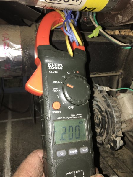

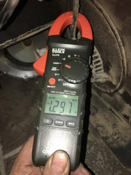

    Did a test with the amp clamp
    The exhaust blower read approx 1.3 amps which is about right.
    The Igniter wires, I did have the clamp around the 2 wires behind the bundle read at most 0.2 amps.
    Therefore is that safe to say the Igniter is not on constantly?
    Pic 1 - Exhaust Blower amp Reading
    Pic 2 - Igniter wires amp reading
    bogieb likes this.

    You have to put the clamp on just 1 wire at a time. It reads the magnetic field generated by current flowing through a wire. If you have it on both wires to the igniter you will have current moving to the ignitor and back which will cancel out.

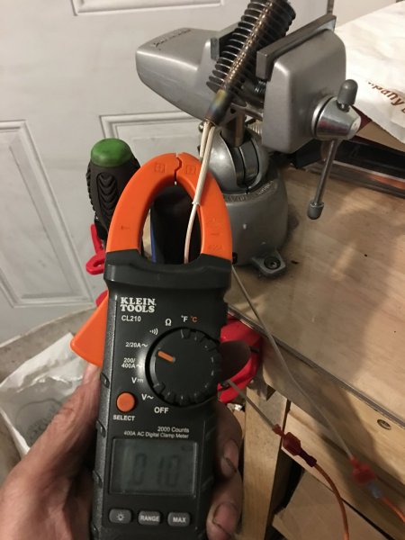

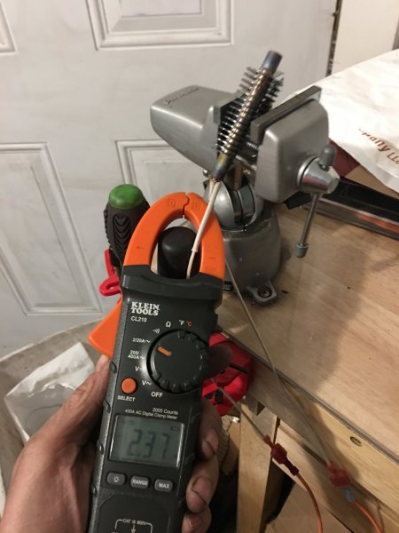

    Ok, here is the bench test.
    E=IR
    I=E/R
    I=117 VAC / 50 Ohms
    I=2.44 Amps
    Or
    P=IxV
    I=P/V
    I=300 Watts / 117 VAC
    I=2.56 Amps
    Pic 1
    Harman Igniter- OFF
    0.010 Amps
    Pic 2
    Harman Igniter- ON
    2.37 Amps
    Looks correct from Ohm’s Law above :)
    Now I can check the stove :)
