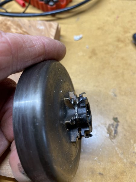

    Anybody know what would cause the chain to wear through the gear like this?
  2. The Wood Wolverine
    17,971
    114,252
    Improper tension will cause premature wear there. That looks pretty extreme. Sure you have the proper pitch chain?
  3. Woodtroll
    Woodtroll
    Jan 10, 2025
    246
    1,804
    Mtns of SW VA
    How many chains has your saw been through on this sprocket? They are considered a wear item. Oregon suggests replacing the sprocket every two chains. I usually get more out of them than that, but it's a place to start, I guess. If you feel it's premature wear, Wood Wolverine made good suggestions.
