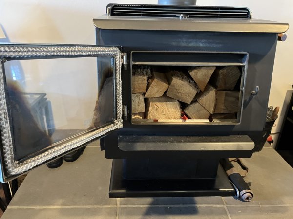

    Well, I joined Firewood Hoarders! Yay! We are in the midst of doing our due diligence on replacing our 20 year old+ VC Encore with a new stove. REALY like Woodstock Soapstone Sotve Company. Visited facotry- impressed with overall business model, care, details, quality.
    We have a 2800 sq.ft. home, however no ideally set up for total wood heat. Impressed by both the Progress and the Absolute. Specs on both put our needs well in the comfort zone. Looking for comments from folks who have used either (or both) of these stoves. Cons - Pros - comments?!
    Thasnk you

    Both smaller stoves. Have you seen the IS model?

    Progressive is big soap stone. total soapstone cast iron frame Not a steel stove 2.8 cu ft firebox
    Ideal steel, I have and use is bigger than absolute steel.. steel stove soap stone inserts 3.2 cu ft firebox
    you will want a big stove
