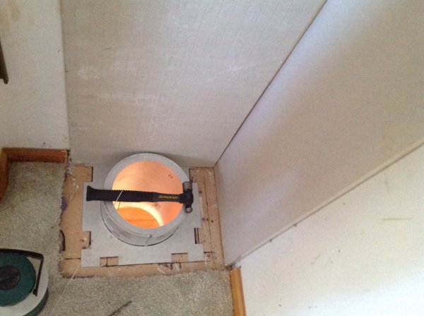

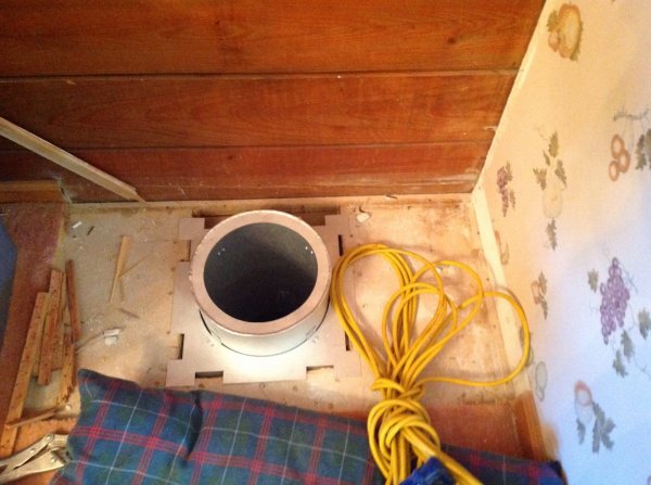

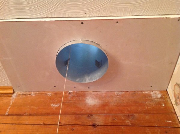

    we are building a basement space that will be a open room, we want a wood stove so we have been building a super vent chimney in the home through two stories, our house is 2600 sq ft without the basement room. We heat with geothermal and it is 36000 btu hours and can heat our home without assistance to an outside temperature of 10 degrees. We were going to use a Napoleon 1402 and have one that is brand new. We have pretty much changed our minds to a free standing stove. Any ideas?

    I am to the point of installing the chimney and plan on going strait into the horizontal pipe but I could go into the top by coming in the wall above the stove, any advantage or disadvantage in a vertical or horizontal installation?

    The straighter the path for the flue the better the draft. By the way welcome to FHC!

    I'm no expert, but as they say, the more straight up you go, the better. If you need to shift horizontally, consider doing it with 30*'s or 45*'s instead of 90* if you can. Here's what our intall looks like with paired 30*'s. Drafts like a hurricane.

    Thanks, pretty stove. I should have 25 feet strait 6 inch chimney with one foot horizontal chimney pipe through a wall thimble them 90 strait down into the stove.

    Sounds fine. Consider 45's if they fit?
