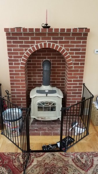

    I already have a chimney, flue, hearth, and stove. This is replacing the 30 year old VC Resolute Acclaim in the main room coming into our house on the first floor.
    To get the stove where it's going, it'll have to go up a couple stairs from the walkway or garage into the mudroom, and through another doorway into the room with the hearth and chimney (hearth is right next to the doorway).

    Got any pics of the above?
    When you say flue, is it lined? With what?
    How are the clearances with the new stove?

    I'm pretty sure the flue is lined. There are two separate flues that share the chimney, one for the oil boiler and one for the wood stove. When the chimney was last cleaned, the sweep mentioned that the liner on the oil boiler was starting to wear out, but that the other flue looked fine.

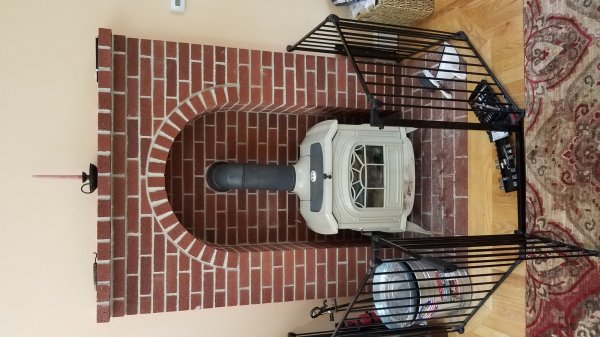

    Clearances look good. I think there's just enough room to place an Ideal Steel on the brick hearth just in front of the cavity where the current stove sits, or extending at most an inch or two into it. That way there wouldn't be anything combustible on either side or directly above the stove. I'm worried that if I position the stove more than a few inches into that cavity (like where the existing stove is), it would sit partly below the combustible drywall that's visible above the mantel and technically be considered an alcove install, which the Woodstock documentation prohibits.
    Hopefully this picture will clarify what I'm talking about (not sure why it's sideways :confused:):

    Make sure you have proper clearance for the loading door.

    Yep, I expect I'll need to put a hearth extension pad in front of the brick and move the carpet and gate a couple feet farther back. Probably ought to do it even if I don't replace the stove right away.

    I agree, you will have to move the IS out quite a distance. 20180916_141340.jpg

    That brick hearth extends 23" in front of the brick faces on the sides of the cavity. Those brick faces are about 3" in front of the drywall surrounding them. So I've got 26" of depth from the front edge of the existing brick hearth to the drywall.
    The body of the Ideal Steel is 23.5" deep, and it looks like the ash lip adds another 4" in front. So I'm thinking I can put the rear edge of the stove 1" in front of where the drywall begins (2" inside the brick archway). That would put the front edge of the stove 1.5" behind the front edge of the brick hearth. With an 18" wide hearth extension pad in front of the brick, I'd have ember protection extending 19.5" in front of the body of the stove, well beyond the ash lip and a couple inches beyond the reach of the open door.
    Does that make sense from a clearance perspective? And is there any reason I'd need to access the back of the stove after it's installed, for maintenance or anything? That would be awkward to get to in that position.
