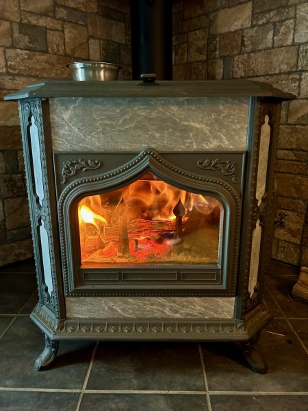

    I've had the Fv since 2013. It took a while for me to get on the 2 year plan with the wood, now I'm pretty much on the 3 year plan. It just heats my little home in north-central Mass. so nicely. It's really the centerpiece of our living room. We've been here 40 years, always had a stove, but this Fv is something special, and it's more than just the way it heats, looks or puts on entertaining light shows. It wouldn't be the same home without it.

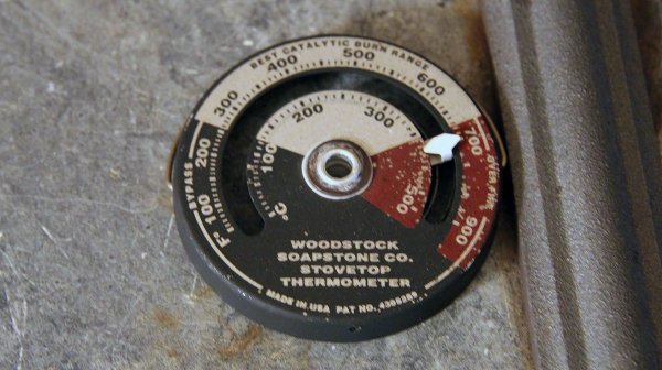

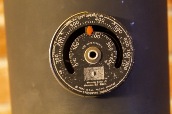

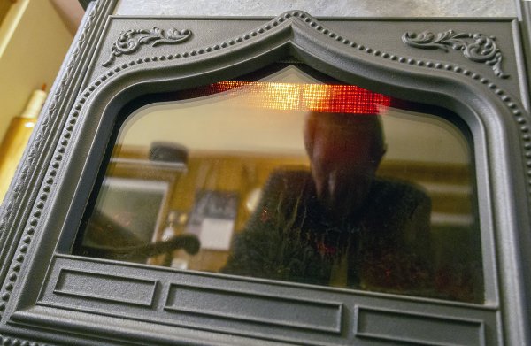

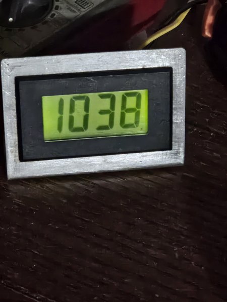

    So I was thinking these things when I went over to check the STT, so I took a couple pics. 32'F outside, 74" inside. Stove draft set at 1. (Cat is a Applied-Ceramic ceramic cat) I purchased in 2018 when the original SS finally needed replacing, and WS was back-ordered.)
    No flames just a slight red on some splits in the front. STT temp doesn't sit there long, it dropped within the hour to 600'F and Flue pipe temp 225'F.

    You might consider a lower setting on the draft. I've been running maybe 1/4 of the way between 0 and 1 and get good results this way. Sometimes I'll set it around 3/4 between 0-1, especially when it is above freezing outside.

    I was thinking the same. It doesn't stay there long, and it doesn't go any higher, but I will give a .75 or even a .5 a try. The 1 position over the last few years has been burnt into my muscle memory, but I really didn't need that level of heat last night. The long-range item I'm looking forward to measuring is the life of the ceramic cat. I do have a Woodstock SS waiting on the shelf, as I placed the order when the other started to fail. But that was 3 seasons ago now.

    Great stove, had one years ago. Used to run mine around .5- .75 mostly for the longer burns and a 500-600 STT. It would really throw the heat at a setting of 1-1.5. Keeping a good flame in the box seems to heat up more of that soapstone verses the lower setting where most heat come from the cat and the top.

    Good points about the heat. Usually for our house, just running on a cat burn is fine. Until we get down into 10'F or below. I know Dennis also runs his in that .5 range. I find my system ((stove/chimney/etc) gets very sensitive to minor adjustments below the 1.0 mark.

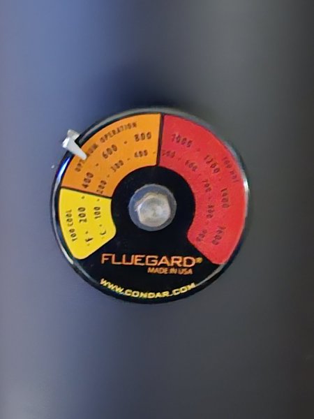

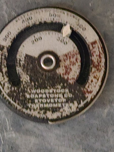

    I’ve been burning with the air fully shut at #0 as well as my pipe damper at about a 45 degree angle. This will not snuff out the flames but they are the lazy slow floating flames above the logs. I get plenty of heat in my small cabin burning this way and figure most of the Winter I will get away with a two load 12 hour schedule.
    I thought maybe there’s a leak somewhere but I haven’t been able to find one. Also checked the air slide and that seems fine. I guess I’ll chalk it up to super dry wood and great draft. The chimney is straight up 22’ half double wall stove pipe and class A. Stove top temps range from 500-650 depending on fuel type and load size. Internal flue temps 400-600.

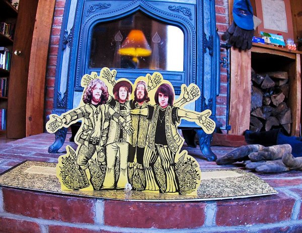

    One of my "oldhippie" photographs, enjoying great and warmth, excellent early 70s music. Due to the great help I've been given here. I forgot I even took this pic and here it pops up again. Thanks for pulling up this thread.
