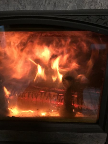

  13. Flamestead
    Flamestead
    Dec 7, 2013
    2,160
    10,926
    Windsor County, VT
    It is likely draft and/or dryness of wood. There isn’t really anything to go wrong on the AS air control. What happens when you leave the air wide open?

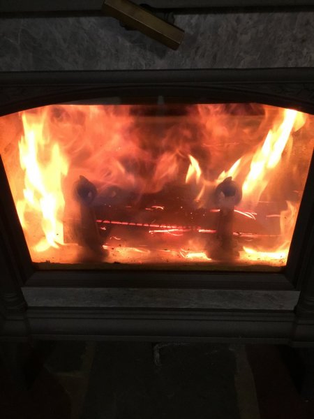

  15. Flamestead
    Flamestead
    Dec 7, 2013
    2,160
    10,926
    Windsor County, VT
    Here’s the PH coming up to temp. Bypass open, air at half. Flu probe at 500.
    It is easier to hit the higher temps by taking a run at it rather than easing into it.
    Ok, flu hit 600 and I closed the bypass but didn’t touch the air.
    Flu at 650, stove top at 400.
    Five minutes later, 625 flu, 430 STT.
    Going to start cutting air now (warm out, and I don’t want 550 stove top).
    Air mostly closed, flu damper half-closed (strong draft here)
    T.Jeff Veal, mat60, Maina and 3 others like this.

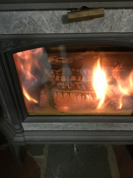

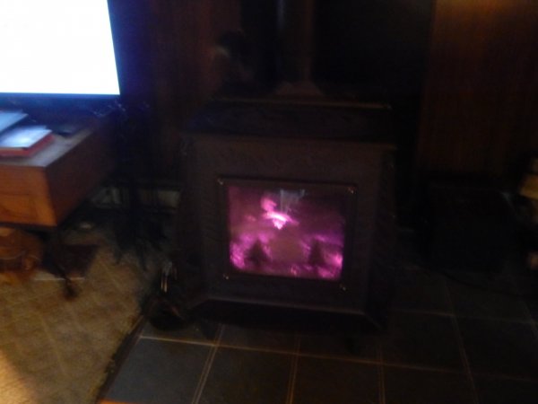

  16. Marshel54
    Marshel54
    Oct 24, 2016
    1,661
    12,894
    Ok. Here are my running stats for the night.
    Loaded all up about an hour and 15 ago. Air opened all the way.Engaged CAT after STT 400 and load was completely charred over. Plenty of flame and eventfully good secondary burn.
    15 minutes later turned the air down 4 clicks.
    Turned air down another 4 clicks after another 15 minutes. A little less flame but still good secondary burn.
    4 clicks down 15 minutes later. Not much change.
    Another 4 clicks down after 15 minutes. Less flame good secondaries and plenty of heat.
    Down another 4 clicks. What I believe you call ghost flames. Occasional flames beautifully dancing around on secondarys. Lifted the lid and CAT is glowing red. That is a rare occasion. Presently at about 1.8 on the inlet air. Plenty of heat in my chair 8 feet away. SST 475* CAT probe 900*. Outside temp. 23*. Coldest it has been since installing the AS. If it continues to perform like this I believe I will be satisfied.
    The colder the outside temperature is the better the thing appears to perform. Still trying to learn. Tonight is the best performance that I have had. What did I do? Don't know for sure except slowly reduce intake air and the CAT is burning. I will have to figure out what makes the CAT burn.
    Picture of my present burn.
    brenndatomu, mat60, Maina and 3 others like this.

  18. moresnow
    moresnow
    Feb 5, 2016
    1,772
    9,952
    :rofl: :lol:Dunno. But it sure looks like you did "something" just right! May just be giving it plenty of warm up time before backing it down. Pics look great!
  19. Flamestead
    Flamestead
    Dec 7, 2013
    2,160
    10,926
    Windsor County, VT
    A little bit later, STT 460, flu probe 580.
