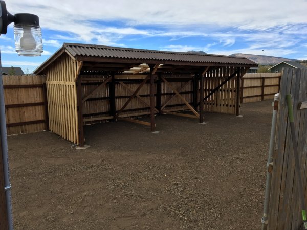

    Here’s mine. I use it to store already seasoned wood but not to dry it. I season it out in the open and then move it into the shed once it’s ready to burn. The center bay has a skylight panel.

    My goodness that’s a pretty woodshed. I was going to go with a straight pitched roof - what made you do the little angle up front?
