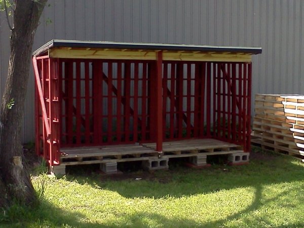

    I'll find a pic of my old one tonight..... I spent $160 after barn and fence enamel tar paper and shingles. I put it up and made it 12" by 4" by 7' tall. It was really nice I actually miss it a lot. In fact I'll probably build another next summer.

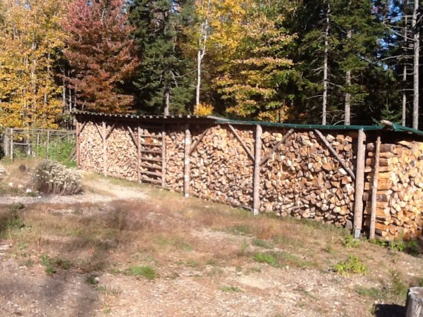

    Same plan, no lumber costs. The posts aren't Cedar so they are not in the ground, I used "Oz posts" and cut the ends of the logs square. So a couple hundred in Oz posts, around $700 in metal roofing and maybe $50 in fasteners. Shed is 50x10.

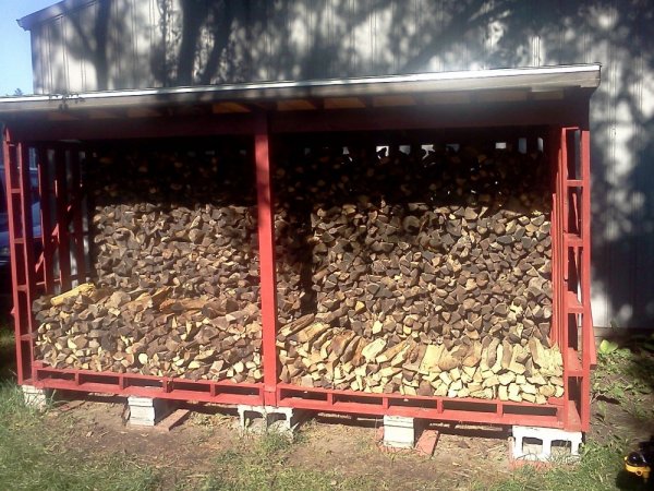

    We built this shed almost completely out of pallets and reclaimed lumber. It was $160 after shingles, Stain and tar paper. I did use some drip edge on it but that wasn't necessary it was mainly for looks..

    That is some mighty fine craftsmanship on that structure
