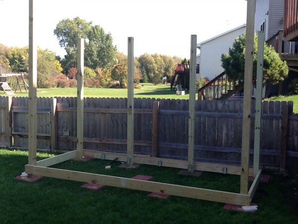

    I threw together a makeshift woodshed last year just before winter with the expectation of putting together a little nicer looking one before this winter. Well, here we are staring the winter of '15-'16 right in the face and I'm just now starting the project. This will only be my 4th winter here in Wisconsin and I haven't gotten used to how quickly they come up on me yet!:bug:I am building a 5X12 shed which should hold around 2 cords for me, depending on hou high I stack. I decided not to sink posts and just build it up on pavers. When we first moved here, I put in some fence posts 4' deep and they have heaved up 3-4" so far. That's not anything I had to deal with back in Oklahoma :picard: Since it's just a woodshed, I'll let the frost just pick it up and let it back down in the spring and see how it holds up.

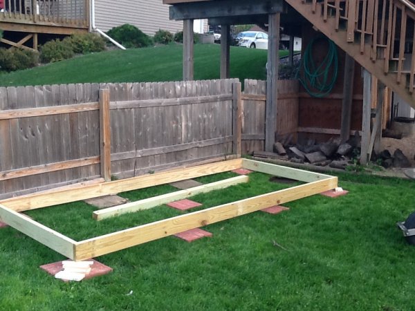

    I started out by squaring up a frame and leveling it.

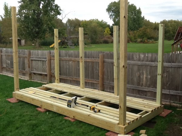

    Then I plumbed and squared the posts and lag bolted them in place and then mounted the joist hangers for the floor.

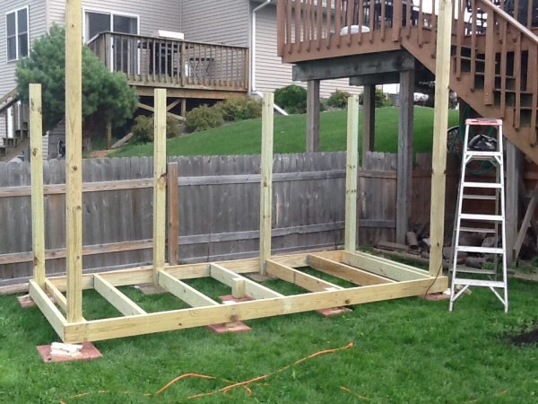

    I cut the posts to height and installed the floor joists.
    I got most of the floor down before I had to knock off for the day. image.jpg

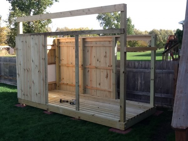

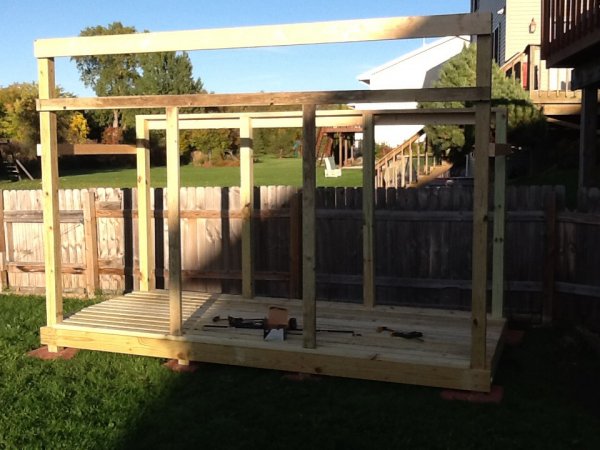

    I finally got to work on the woodshed a little bit today. I finished putting the floor down and then put the front and back headers on.

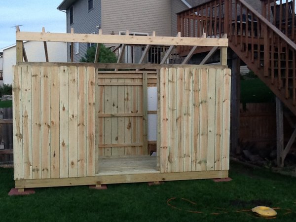

    Next, I started to put the sides on. I'm using 6X8' privacy fence panels for my sides. It's what I had used on the POS woodshed that I threw together last year so it will let me reuse them on this one.

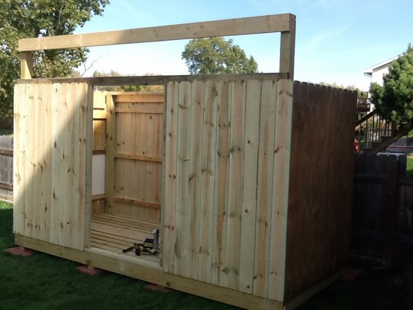

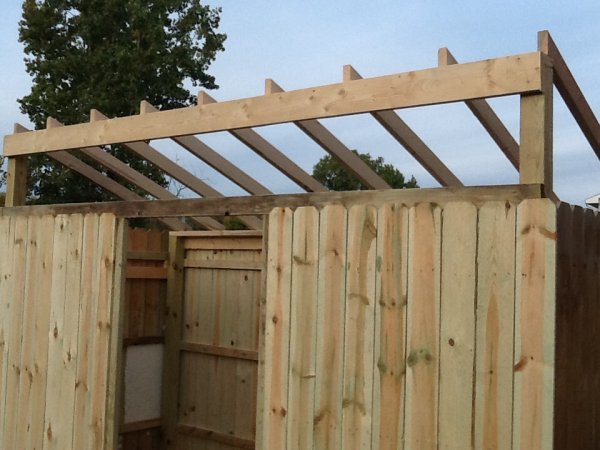

    I finished putting the sides on and then put the backside rafters on.
    Tomorrow, I hope to finish the front rafters and the top portion of the sides and front.

    Do you plan to leave the opening above the fencing panels? Might be a good idea...it's a beautiful shed but air flow concerns me...I think I would leave it as is, attach roofing and be done-just my opinion, fwiw-nice looking work!

    Very nice Brad! That will be a great BTU shelter. Will you have any ventilation in the shed?
