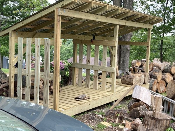

    Here it is 8x10x8. Should be right around 4 cords when jammed to the rafters. Built in June, so could have added a new stove to the house for the price of the lumber But needed a place for wood at the new house!

    I love it. Well built and thought out. Is it your own design?

    Thanks!!! Kinda mine. Looked at a million pictures and kinda went from there.

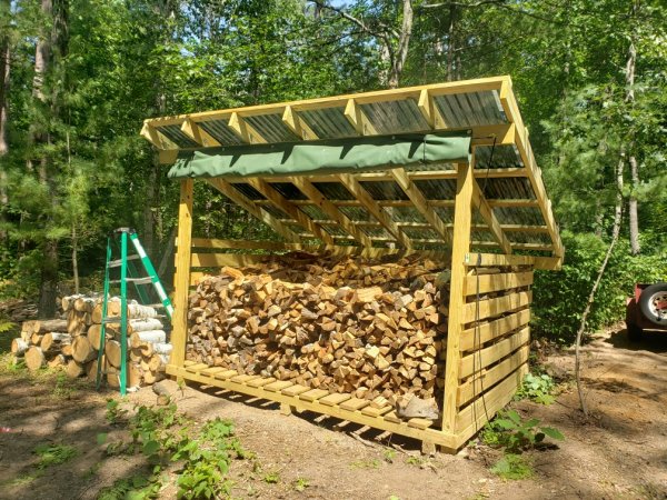

    Looks kinda like mine. Great minds.....[​IMG]

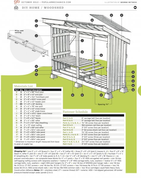

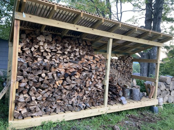

    5F76875F-2BB3-4CE0-B167-E90244D27B24.jpeg Here’s the plans I used, except I made mine 60” deep (5 ft) instead of 42” as it says in the plans. 9567E011-609E-41DD-AB5B-91B0774999C5.jpeg EE1F5CA8-D6AF-4535-A425-56A4B66679DE.jpeg
    …not sure if the woodshed plans came thru. I’ll try to attach a separate pic of the plans…
