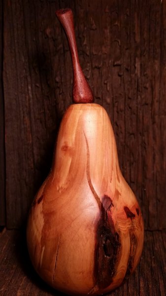

    But Lukem is right, sharp tools will make it enjoyable. My son is 11 and took to turning very quickly. He just has a knack for it. Here is his first mallet in pear wood. I think this is his third or fourth small project.
    Here is a pear I did out of the same tree. It is fantastic wood to turn.

    Fishingpol, that pear is outstanding!! Mattjm, I teach Ag. Ed. in a high school setting. I also teach a few sections of woodturning. I will respond later with a good list and some possible suppliers. You have gotten great advice in that large bowls require large lathes. There are also some options. Welcome to the vortex, it will only pull you farther and farther away!!
