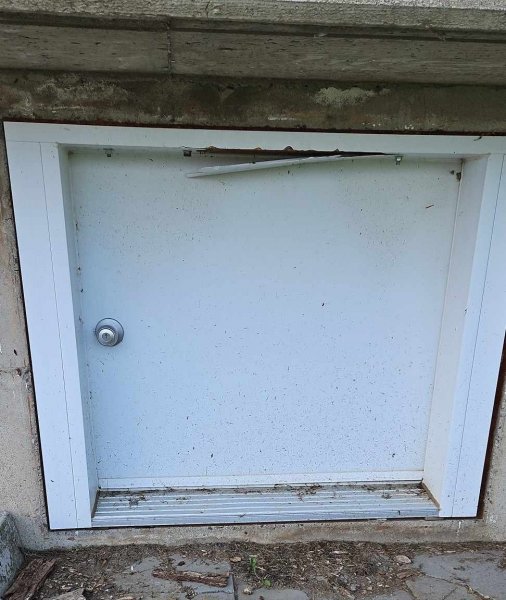

    I'm building a new house and want to install a trap in the concrete foundation where i can drop my wood directly where it's going to be stacked.
    My cousin has a small door like the attached picture, but i had one quoted and it's 650$ CAD so I'm looking for cheaper options!

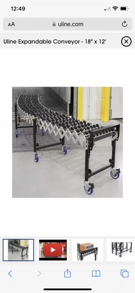

    X2 A wood chute or a nice Conveyor belt?

    If your foundation isn't done and is going to be sticking out of the ground like that, building a door like that shouldn't be a problem. Have the foundation guys leave you the opening you need. Cutting down a solid core door would work.
    Or since we're spending your money add a bump out on the foundation like a you would for bulkhead doors. Make it like 8x8 and instead of a bulk head, frame a room without a floor and doors to the outside so you can dump like 2-3(maybe more) cord in the at once and just leave it right there.
