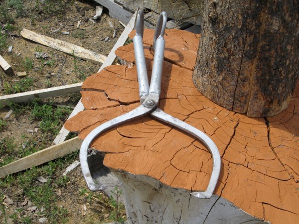

    I just though I would share this. I found an old ice tong at a flea market and cut the handles off welded in some pipe to make them
    longer and welded the handles back on. They worked great and sure is a back saver with the long handles and they cost me almost
    nothing. I was moving some 7ft logs around yesterday and what a help.
