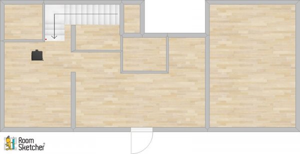

    The path for the heat to reach the western side of the house is next to impossible. Here is rough drawing of the house.
    First Floor (notice wood stove on left side of house. Also note that the stairs go up to the second floor.)

    From this shot, I see an opportunity to drop a duct in your room(hope I got that right) at the opposite side of the house from the stove, back down to the stove floor- did I miss what room is under your bedroom?
    You can enhance natural convection by giving the cold air along your bedroom floor a way to "sink" back down....

    Register to allow heat through the floor?

    I was suggesting a duct back down to about 6-8" from the floor surface of the same floor the stove is on... To allow the "cold air blanket" some place to go....
    But a register is also helpful at letting heated air along the lower floor's ceiling to continue to rise.
    But the cold air still needs to be "evacuated."

    boettg33 the suggestions here are sound. push the cold air to the stove with SMALL fans(small enough to not make turbulent air but move the air) or provide a duct or floor register for the cold air to return to the stove on its own. dont ever try to move the hot air where you want, the laws of physics (High to Low) will always win. BTW i use an oil filled heater in my sun room where my dog crates are, its the hardest room in my house to heat, I only REALLY need it below 20 degrees but its there and works great. I hope yours has a temp scale for degrees on the thermostat for it, ours doesnt and makes it hard to find the sweet spot.... Also, use it on the lowest wattage/output setting needed to do the job, higher isnt better, the oil is there to be a ballast. if its set higher you will have wild swings in temp as the ballast heat is used up and cycled on again, not good when sleeping. Low and slow.....

    I put in a floor register in the bedroom upstairs with the open and close louvers in it. The heat rises from the living room downstairs where the stove is. The cold air slides down the stairs to the living room to be heated, this brings air flow past the bedrooms in the hallway off of the stairs. Those rooms are cooler, but heavy quilts keep all comfy and warm. We frequently have to close the louvers on the register as the upstairs gets too warm. It works for us.
