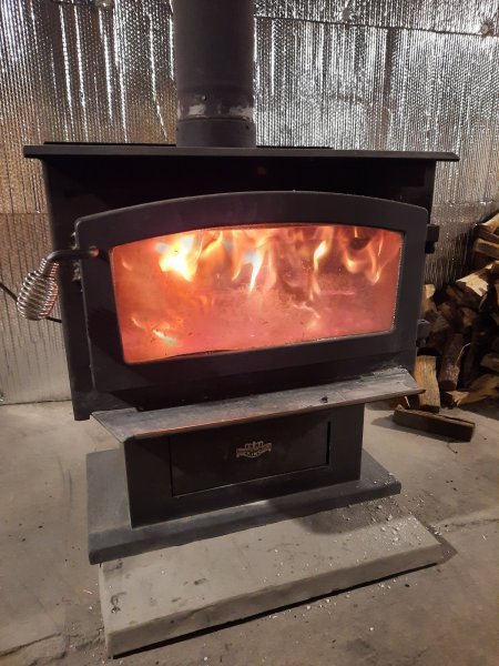

    10. This is what it looks like when I usually leave it alone. 20201112_223531.jpg

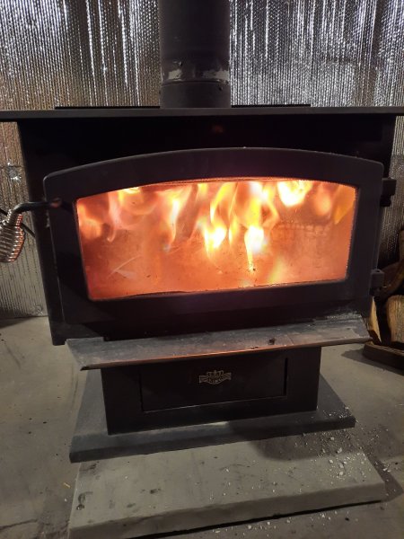

    Here is a picture of the stove fully aflame and damper shut all the way. It looks as though the air inside is on fire not the wood.
    20201112_224831.jpg Now, I have seen some videos of stoves burning with almost no flames. Should I just load it with wood and walk away? Am I wrong getting the whole thing raging before I walk away? I thought that anything other than a very hot burn created creosote.

    Steve, I think your problem is in your thinking about running the stove. It appears what you are doing is simply burning up the wood before you are ready to let the stove do what it was designed to do.
    One big point is your last statement about burning hot so no creosote. Burning hot is not the key to this; burning dry wood is all it takes. And if the wood is dry, you can burn low and then enjoy the heat rather than sending most of it up the chimney like it appears is happening.
    In answer to the above:
    4. The fire does not have to be raging! It needs to be burning but after it gets started real good, then it is up to the secondaries to cause the raging fire. Don't think you have to give full draft other than when you are starting the fire.
    Do you use temperature gauges on the stove and flue? If not, do yourself a favor and get at least one good one and place on the flue then keep watch of it Chances are you very well may be getting that flue too hot! Most are designed to not get over 500-600.
    Also, always remember that when you have the drat open full, you are not getting much heat from the stove. Why? Because you are rushing that heat up through the chimney.
    5 through 10. Close the door when the fire is raging? WRONG!!!! Get the fire going and then shut the door! Quit depending on getting the air through the firebox door. This is not how the stove is designed to run.
    Once more, make sure you are burning good dry wood. It can help if some of the starting wood is kindling wood and also some type of wood that is quick to light off and burns fairly hot.
    The 2 I like most are pine or soft maple and I tend to use soft maple for kindling. That is because it dries fast, is very easy to split , it lights off fast and burns hot. I will also use a good fire starter like super cedars and use 1/4 of one super cedar to get the fire started.
    To start the fire like I did this morning, I laid 2 splits of pine in the bottom bark down, forming a slight V.
    then laid 1/4 super cedar in the V and lit it. The 2 small splits on top, being careful to not snuff out the fire. Then I closed the door and waited. Of course the draft was open full. Within 10 minutes I had to turn down the draft lest the flue get too hot. Once the stove top got to 200-250, this is where you are ready to get some serious heat! I then set the draft to approximately 1/4 of the way to full. In my case we have a cat so I then close the bypass which will light the cat (In your case you would be really be starting your secondaries good.) At this point the stove top temperature will then begin raising fast and you will like it.
    After maybe 5 minutes or so, depending on the fire, I'll cut the draft a bit more and go to bed.
    Steve, I really hope this helps you and it should. Also, have you ever read the Primer on Woodburning by Backwoods Savage
