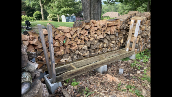

    I used cinder blocks and 8ft treated 2x6s. Blocks at the ends and middle.
