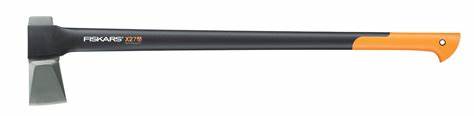

    In the mean time:

    You splitting vertical or horizontal? If horizontal, that might be your problem. Where was your milk crate in relation to the splitter?
  16. buZZsaw BRAD
    32,630
    199,453
    I LOVE that axe. Cant tell you how much wood ive chopped with one!

    The axe post is perfect:thumbs: A fine tool.
