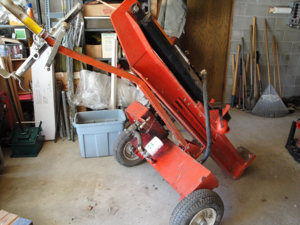

  13. Erik B
    Erik B
    May 12, 2015
    5,225
    35,496
    Western Wisconsin
    This is how I had my Speeco when I changed the filter. Didn't lose any oil.

  14. farmer steve
    farmer steve
    Feb 17, 2016
    1,965
    14,361
    top of the hill york co. PA.
    My TSC splitter has the filter that has a integrated bypass on it.

  18. creek chub
    creek chub
    Jul 11, 2016
    319
    1,471
    Va
    Do you lose much fluid changing it elevated like that?
  19. Erik B
    Erik B
    May 12, 2015
    5,225
    35,496
    Western Wisconsin
    Practically none. I may have had a small pan under it when I first removed the filter. I may have lost the oil that was in the filter.
