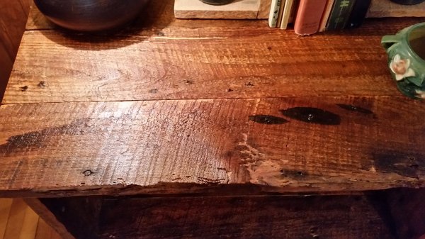

    Ah, right up my alley. I like to see the grain, especially if it is rough-cut and not planed. I helped my brother-in-law build this book case using rough pine from the sheathing on a cottage. It was very lightly sanded with an orbital sander with 220 grit I believe. I mean very light. So the high spots took a little sanding and a bit of the crud was left in the low spots. We brushed it with a medium stiffness poly brush like a deck scrubber to loosen the dirt. My dust collector and respirators were used because of the fine dust.
    After that it received a few coats of semi-gloss poly. All the water and bug damage was left in place as well as a few nail heads. The nails were countersunk so the sander would not take the light rust coat off them. We poured the poly into a small disposable bowl so we would not contaminate the clean can of poly. We used a wide disposable hog bristle brush and went to it. The dry wood drank up the poly. I am looking forward to see what you do with it. I also like that clamping straight edge. I've never seen one like that.

    That looks great! I can probably get by with a light sanding on the outside, but some of the shelves have dark can rings (maybe from dripping stain or paint or oil) so I'm wondering if I should do something different with those.
    I was noticing all the holes from nails/brads etc on the outside, thinking that I would have to sand the bejesus out of it and then fill the holes before doing anything else, but you may be onto something - I love that look. I still have more cleaning (the brush is a great idea - I'll get one tomorrow), but need to let it dry out to see where it's at at this point.

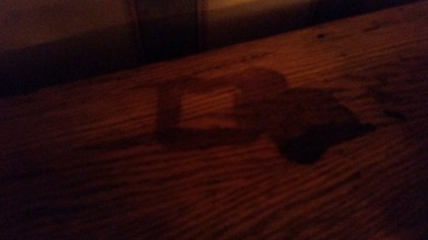

    I vote for leaving the character in place. I have a piece of furniture with an old square inkwell stain. It can never be removed, but it is part of the story of the desk.

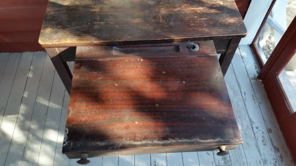

    I have this nice nice mahogany writing desk from the early 1900's that needs a full restoration once I get my shop cleaned up. It has the original ink well in the pull out drawer. The drawer top lifts up to store paper.
