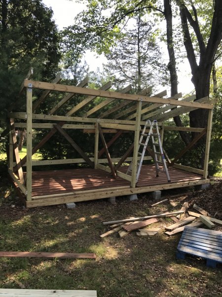

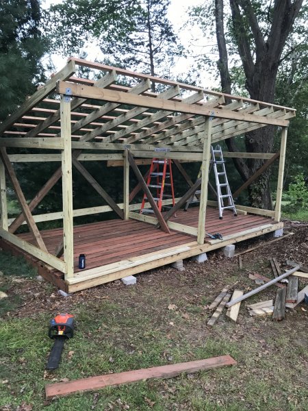

    I got bored painting the deck railings so over 3 days I decided to build a shed. IMG_2654.JPG IMG_2657.JPG IMG_2660.JPG IMG_2662.JPG Used about 60% reclaimed pt 2x6 from a deck i redecked two years ago. Shed is 20x8x8ft tall sloping to 6. Probably need to redo some braces as i just threw up random scraps. About another week before the metal roofing comes in.

    My carpentry-fu is lacking so i used simpson strong ties. Made things simpler for me. H1Z ties for the rafters, and the header ties for the header. Hardest part of doing the roof imo is putting up the header. I used a doubled up 2x6 with a 4x4 sandwiched because i had it free and available, otherwise it probably should have been a 2x10 or so. The purlins or nailers were just 2x4 non pressure treated and screwed to the rafters. Make sure to use screws instead of nails for the purlins/nailers.
