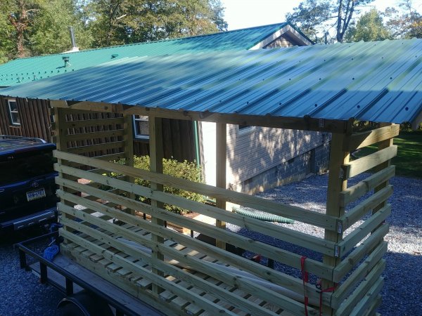

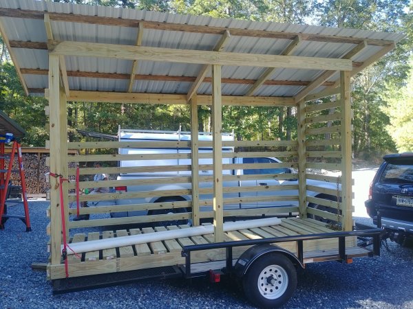

    Heres the wood rack build for today.....i need to check with those FFA students n see if they're still building them....definetly cheaper they are...
    Put it together n loaded on trailer to find a home behind the garage.....
    oopss....need 3 more treated 2x4x12s to finish the back...
    I also like my roof better than the ones i bought..

    Looks great!! Nice work, bear! How much do you figure it'll hold?

    Between 2 3/4 to 3 cords......12 ft. wide...4ft. deep....8ft. tall in front....7 ft. in the rear

    Looks great Bear. Steel is the best choice for the roof.

    That’s one styling wood rack - kudos. Mind me asking - what’s something like that cost?

    Looks good! Were you able to scoot it around by hand, or you have some mechanical advantage?

    Great job, i like the design and airflow will be perfect.

    I have about 400.00 in materials....
    All treated lumber (except for the perlins)
    5) 2x6x12...11) 2x6x8....13) 2x4x12....16)2x4x8....4) 1x4x16.....5) 39" x 7 ft. metal roofing (seconds)....3" deck screws in the bottoms...2 1/2" for the rest..
    One of our members posted a facebook find about 2 years ago that the FFA students in Hancock, MD were building n selling these. I bought 2 for 350.00 ea.
    I thought I'd give it a go n build at least one myself with a few alterations (bigger roof....sides n back boards closer together)
    There price went up to 400.00 n if they are still building them when i get the funds for 2 more....i may just get them from them...minus the roof....i'll put my own on

    We built everything except the roof in the garage....then i hooked a chain up n drug it out with the little kubota GT...
    When we got to the edge of the concrete...we put 2 pieces of 3" pvc under it n rolled it. When we were done....we hooked up a come-along n winched it up onto the trailer.....its definetly got some weight...

    Very nice work and well thought out.:thumbs:
    I like the fact its on a trailer so you can move it around and if necessary drive down the highway so it dries the wood out faster!:rofl: :lol: Gotta hand it to you on that one. Cant say i wouldve thought of that!
