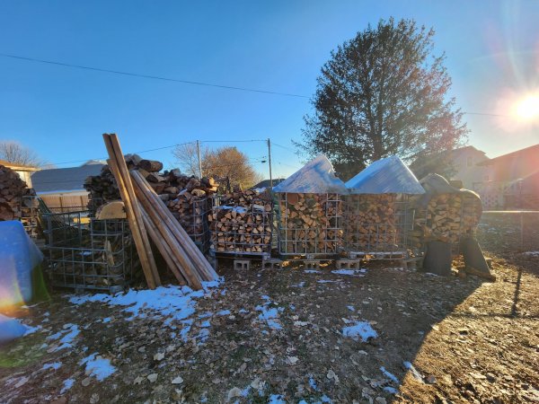

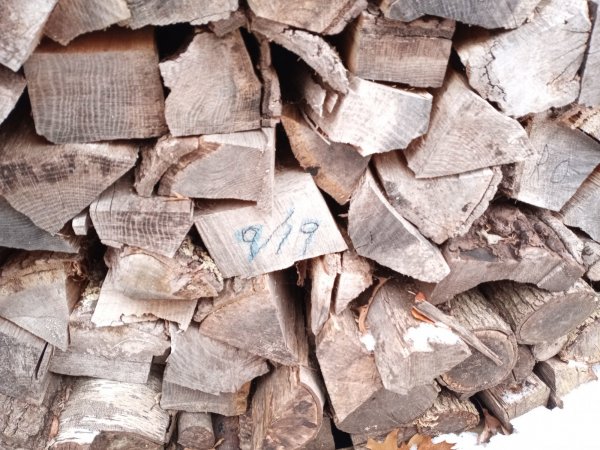

    You want to get on the 3yr plan. Burn no wood unless it's been cut, split, and stacked 3yrs. Some species do dry quicker, but 3yrs it'll be safe.
    I have a number of 8ft racks that I stack 16" splits on, to a height of 4ft. IE: 1/3 cord.
    I'll date the wood on any given rack with the stack date.
    My woodyard had grown organically. As such, my oldest stacks are all over the woodyard, not in just one place. Works for me!
    Mire info and pics can be found here - This person's woodyard nirvana...kinda....sorta

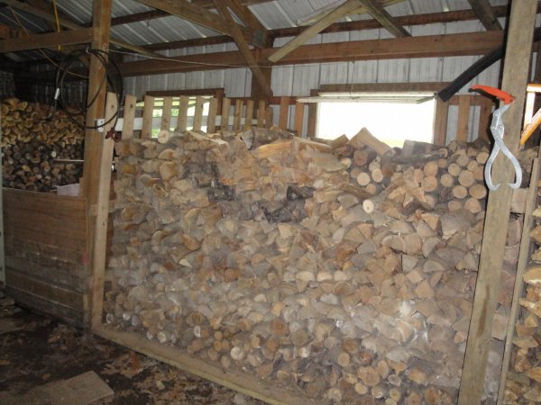

    Eventually all of my wood ends up in my pole barn. I have made separate bins (that is what I call them), each about 8 feet square and piled around 5 to 6 feet high. I have 5 of them and I simply go in a clockwise direction for use. Makes keeping track of what gets used next easy.
    DSC02654.JPG DSC02656.JPG DSC02658.JPG DSC02659.JPG DSC02661.JPG The barn holds around 3 years worth of wood.

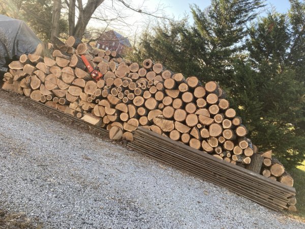

    I am still working to get to the 3 year plan because I fell behind after my twin girls were born. Because I'm not there yet I do separate species somewhat. I keep oak isolated to its own row. Anything that takes 2 years to dry has a row. Everything else gets mixed together.
    Here are some pictures that will help explain. Plus we all like pictures....
    This is where the wood that will be burned this season ends up. I have been going through anywhere from 3 to 3.25 cord/year. This is likely to go down though as I've discovered I have an overdraft and have begun using my pipe damper but that's another story. I'm just over halfway due to the mild winter we've had.
    Here my storage area. I stack 2 rows/pallet and go 5 pallets in length. I estimate there to be 1.5 cord or so per each 5 pallet row. I need another truckload to finish up the row on the left. That is all for next year.
    These rows are longer drying woods. The row that is covered is all oak that will go through its 3rd drying summer this year. The uncovered row is a mix of hickory, black locust and a little bit of oak that was left over from the other stack.
    The rounds that were pictured will be split and stacked for winter 25/26.
    Once I complete the 3 year plan I won't separate anymore. Oak will go right in the row with everything else.

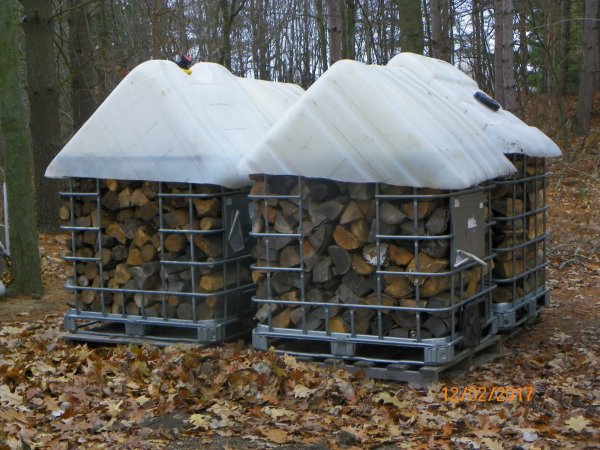

    You will notice I use old galvanized roofing to top cover. This has worked out well. In recent years I also use a few of these:
    Overall I do not feel the totes are the best yet a few of these can work out handy. It does prove to be more work getting the wood out.

    The logs and rounds you have laying around, are they on the ground or do you have them on pallets or some other way of keeping them from pulling moisture until you get them split and stacked? I’ve been debating clearing an area next to my driveway, putting some stone down and using that as a “staging area” for wood I gather over the winter that will be split come spring time.

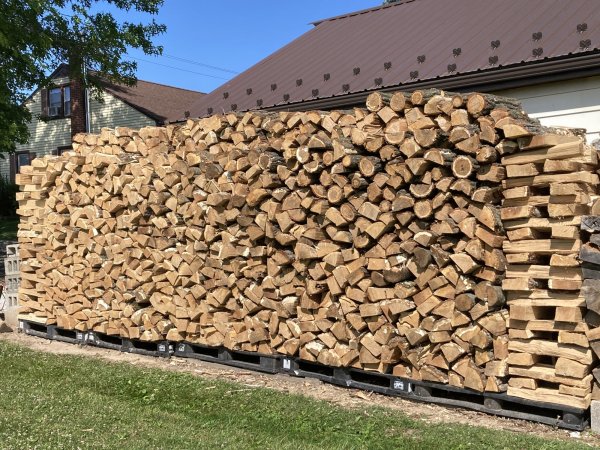

    I’ve been burning since 2010, found FHC a couple years after. Learned of the 3 year plan and that really helped my wood burning experience. I noticed a significant reduction in what came out of my chimney after sweeps.
    I stack two splits side by side on plastic pallets, running north/south, and the row gets very good sun and excellent wind exposure. Those 2 go up about 5-6’, then I stack one row in the middle for another 12-16”, so my top cover doesn’t hold water.
    It took me till a few years ago to learn to crib splits to separate specific wood scores, or basically sections that will get used per season. So I can remove what I need to burn that year w/o the pile partially falling. Hopefully you can see what I mean in the pics.
    CFD2144E-4E6F-48CF-BA47-80CD0DF2F0EC.jpeg DF195934-3066-42EC-B419-7D370899A382.jpeg B774B454-44F8-46E4-9317-094B242BCBDE.jpeg
    This stack is over 70’ long but sectioned out with the cribbed ends. This allows me to take wood without disrupting the rest. I started out w/ T posts on the ends, and tied rope at the tops from end to end to keep posts from bending. That worked for many years till I found a better way. The cribbing also allows me to section out a different species of I get enough to do so. Which I have. All that wood is chestnut oak except a 2.5 cord section of honey locust and a 1 cord section of black locust.
    I bring wood home in rounds and stack in a staging area, then when I split, wood gets thrown into a trailer to be taken to stacks as it's filled.

    Okay, I’m jealous and wish I could have a setup like that! I like that you have 3 years worth under roof and keep it simple by rotating in one direction. Thanks for sharing as I now have something to work towards. In all seriousness though, you have a great setup there and I’d very much love to have something like that one day.
