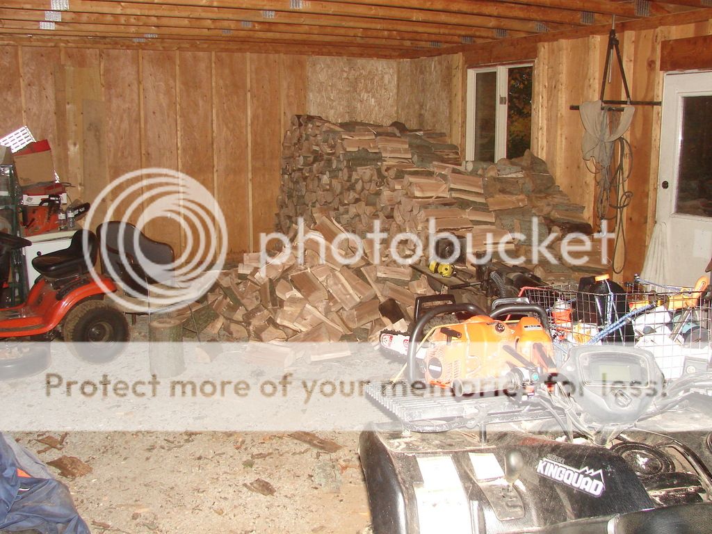

    This Red Maple is gone now Nemo as I share a lot of my wood with the lady that owns all the land I cut on plus the swamp down past her land from a nice couple of horse people.:yes: and was css live blow downs from the swamp, windows and big door are always open.
    Was just informed 11 months the way it sat and the T5 ran great when it was thrown in.:coldone: You wont be disappointed next year.:salute:
