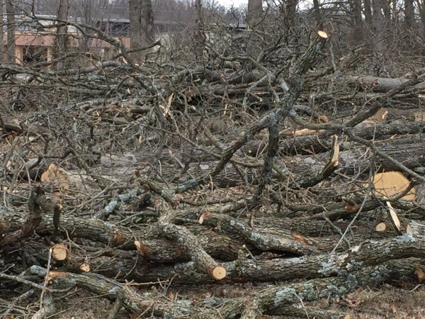

    I’ve got this to deal with if one neighbor or the fire chief won’t okay burning a large brush pile.
    Really thinking about getting the 10 or 12” chipper and a mini excavator with a thumb and feed it as fast as I can push piles of brush up with my tractor and loader with forks on it.
    Either chip into large piles for later use or into a couple 40 cubic yard dumpsters for hauling off.

    Conservative estimate is I’ve got 40-50 cords of wood on the ground to deal with. Giving a bunch away in log form and giving permission to almost anyone who ask to cut all the want. Simply not enough time or energy to deal with cutting up branches. I want them gone in fastest most cost effective manor. Logs can be stacked and dealt with later.

    What a mess! What happened there?

    It's a mess but looks like there is a lot of good wood there.

    Easy Livin' 3000 no stress just a lot of work to do, I’m working 60+ hours a week and had 75 trees cut down on a property I just purchased, trying to get it cleaned up and ready to open a new business.
    JPDavis yep it’s alot bigger mess than it looks!

    12 inch chipper minimum if you are going to try to feed with a machine usually on small clearing jobs we had a 18 inch cost @400.00 a day and we used a machine with a grapple to feed looks like a lot of firewood there but if you are in a hurry just remember that when you open up the job and let people cut firewood a lot of times they will cherry pick first and you will be left with a lot of short cutoffs forks and short piled branches which are a mess to deal with for cleanup you have to hand feed short stuff tough to do with a machine sometimes it sucks having to chip all that wood but if you are in that much of a hurry it is the faster way just remember it will be one hell of a chip pile when you are feeding with a machine you are also able to pre crush a lot of the forks before you put them in chipper almost forgot make sure chipper has auto feed if you are feeding with a machine

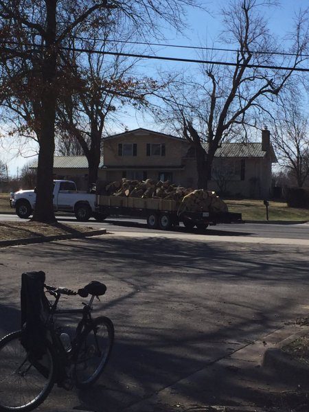

    5F039114-9408-425B-AEBF-02ACFB2B6D84.jpeg JB Sawman 12” machines rent for $550 day here, I’ll check on 18” and tub grinders, good the know about confirming the auto feed. I’m keeping the cutting to friends and family so far they have taken at least 2 large gooseneck flatbed trailer loads and numerous pickup loads out and barely dented the pile! Next weekend we will have tractors and loaders out there to skid stuff closer to road, loading logs into trailers to cut up later and making me a pile of logs I will keep for lumber and firewood!
