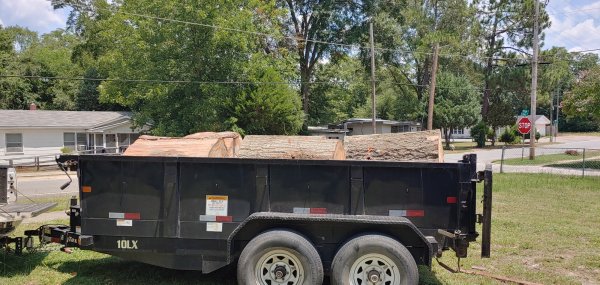

    We have air bags on our F150, helps when we deliver a load of wood or pull the trailer. Normally when we bring wood home to process, it's in the 7x12 dump trailer... 0725231319a_HDR.jpg 0725231132_HDR.jpg 0529231411.jpg
