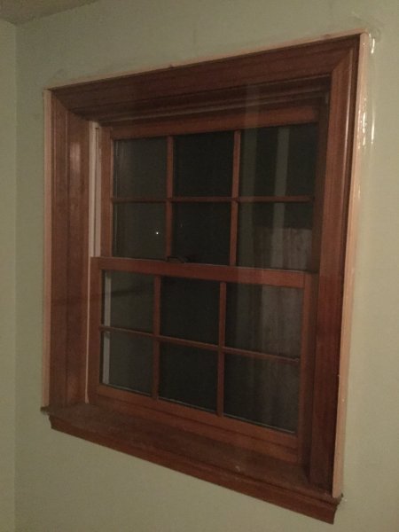

    You can try what I did. Box in the window trim and apply the shrink window film. Did it to 9 out of 10 windows on my second floor and it has reduced the difference in temp between first and second floor.. Prob ran me $30 for the initial setup. Now $12-15 per year to reapply the film. Had to adjust the curtain hangars on the windows... the added frame is a bit unsightly but we’re not scheduled for a photo shoot on better homes and gardens ay time soon.. prob saves me .5 to .75 of a cord per year. here’s a pic. the windows are original double pane windows from 30 years ago.. you can see the 5/8”x 1 1/2” pieces used to box in the window frame..

    If you have old loose leaky double hungs these indoor storms work fairly well.
    If there's no insulation between the window and the frame then pull the trim off and use the low expanding foam.
