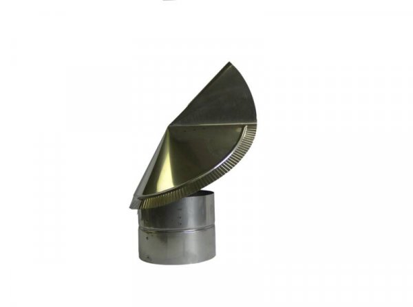

    Still haven't ordered the chimney for the new stove. Do any of you have experience with a special wind chimney cap, if sp what kind. Will they just fit or do they need adapters

    I am not familiar with a wind chimney cap. Could you share a photo?

    Yes, we are on the side of a hill and get very strong downwinds. The winds here are very exaggerated.
    Here is an image of one i found.

    Sounds like you might need one of those,
    You probably don't want to buy two different caps but you could try it with no cap to see how your draft is first, for comparison

    When I lived in Alaska, folks that lived on the buff along Cook Inlet
    had to have directional caps because of the wind.

    i thought about wind caps but talking with companies, I gathered it also increases draft. i added 3 feet of stack and a selkirk class a cap and did the trick for me. It depends on the situation.

    I have a problem with strong winds back drafting into our cabin( home) . A friend who comes from the Oregon coast told me about a swivel chimney cap that looks like the ones Justdraftn posted pics of.
    Our strong winds come from both north and south so I need one that can swing around like a weather vane.

    Thank you everybody for all the help. Cold trigger finger, I strongly suspect we'll have to get a cap like that.
    However, I don't want to end up with really bad updrafts and go through tons of wood.
    I have ordered the regular cap for now. We'll see how it works and go from there.

    If your stove is an air tight stove. It will only draw as much as you let it by opening the draft. When a wind event is happening , either the stove will draw real well Or it will nearly or actually back draft. Wind is wind. . Its a variable medium. Anyway the information is there if you do need it. I will be ordering one as I can afford to close my stove all the way down @ 30 below . Just because the wind came up.
