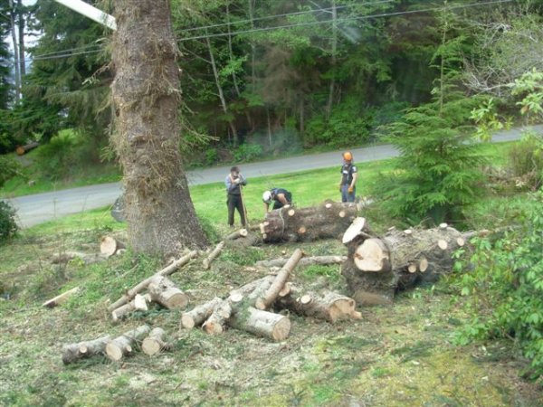

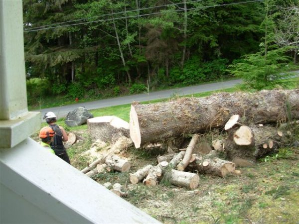

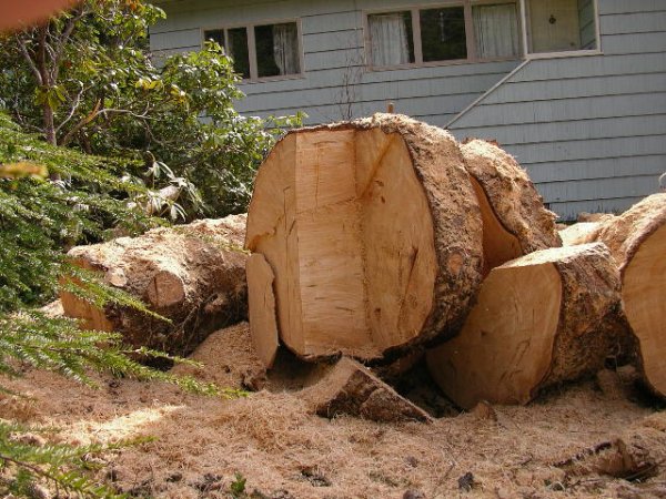

    This is Sitka Spruce and it is and was the toughest tree that I have ever split , 3 days with a lot of noodling!
    No description necessary the pictures say it all!

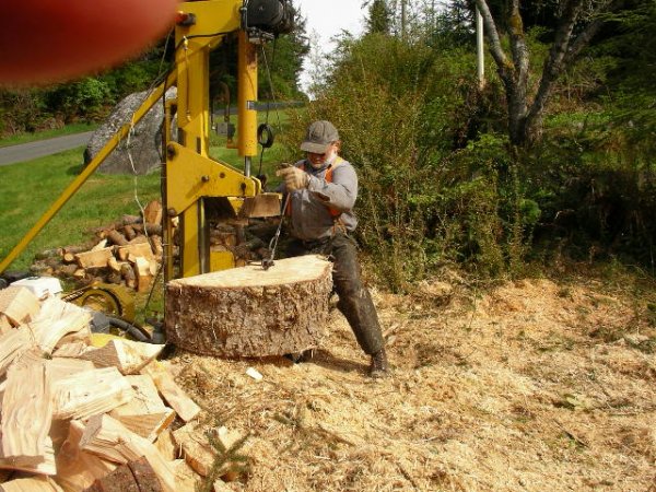

    You Canadians grow em big out there Camp! And love to see those pics of your old splitter. Three decades you've gotten out of her?
    Woodwidow and campinspecter like this.
  20. campinspecter
    campinspecter
    1,680
    12,219
    The tree was in Granny's front yard. When Granny and Woodwidow's Dad built their house starting in 1949/1950, the lot was skinned bare so the tree was about 60 years old when it was taken down. One thing that really aided its growth was that it grew over top of the septic tank and perk field. The tree had been topped twice in its life time; the last time by me in about 1975. When the Electric Company expressed a desire to take the tree down, it had power lines on 2 sides and was leaning towards Granny's house on a third, so we were more than happy to have it taken down (free of charge). They asked how tall it was and I said around 90', the four major tops started at about 30 feet from the ground but with the bucket at full extension, it was too short , they figured it to be closer to 130'! Limbs over 3" in diameter were cut into firewood lengths. The total of about 7 cords came from this tree. Another humorous aspect of the splitting of this tree is that at the local coffee shop they were running a pool as to how much of the tree would get split before I gave up.
    The splitter was new in 1984 and is showing no signs of giving up. It's on its second engine and all hydraulic components have either been rebuilt or replaced.
