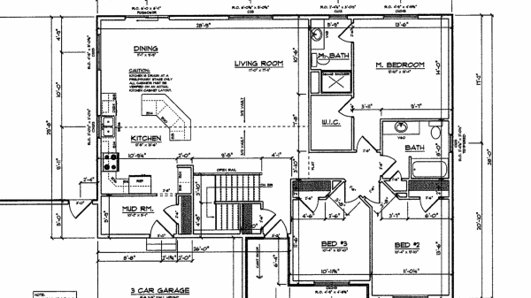

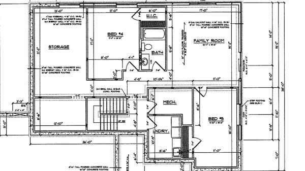

    Going to be building a house with about 1400 finished up stairs. Open kitchen and dinning w/ vaulted ceilings. 3 bedrooms on one end. And 1200 downstairs when fully finished. (Basement will slowly get finished as $ allows)
    Stove will be placed in basement opposite the stairs. Where the W.I. closet it is. The plan is being changed and the bedroom/bath area will be moved over to the left and take the place of the "storage". With out a blower am I going to get decent heat to the stairway? I do plan on pointing a floor fan at the stove.
    Here is the upstairs:
    Plan on putting a floor fan by the bedroom doors as well to help with a convection loop there as well. Will have a ceiling fan in LR in the vaulted ceiling too.

    Partitioning off only the family room for the first year or 2. A wall will go all the way across in the new bathroom location ( just to the left of the rear center window) with a door on the stairs side to still access the other end, that side probably wont get finished for a few years. So everything near the stove (family room and bedroom 4) should be close to finished by winter 17-18. Dont fully expect it to keep the furnace from running but I will sure try! Just won't have the $ to plop a BK in there! If it keeps the basement kozy and the upstairs warm I'll be happy!

    I think bedrooms M, 2 and 3, and baths in same area, will be difficult to heat as the majority of the heat will be trapped in the vaulted area. But being a new construction and you already know you need big time insulation and gap sealing, you will make out just fine.
    Do you know what insulation the contractor will use and how much?
    A few thousand dollars spent in the right places now will save you a lot of money later.

    The vault is only in the main living area up stairs and their will be a ceiling fan or two to help move the air. According to the wall section scematic, insulation will be r-19 walls with r-49 ceiling rating. Basement will have r-11 batt.
    And now that I relook at the actuall printed plan, each level is 1585 fin sq ft!:hair: So I think that may rule out the IS.:( Unless I buy 1 for each level...... Or wing it and it heats what it heats. They look cool and I still can play with fire!

    Personally you are going to be heating 3130 square feet some vaulted. some helpful hints. put more than R11 Batts in basement. Do an inch or 2 of spray foam then put your R11 Batts in 2 by 6 walls. You have a great floor plan is your house facing south or south west? are there more windows on that side to catch sun? what about other heating system if forced hot air have some blowers put your cycle cool air out of basement to upstairs (easy AC)...

    I will have a NG forced air furnace as well. I know its relatively cheap but we have gotten used to 72-74 degrees up stairs. Can get costly keeping a house that warm though!
    The front of the house will face pretty much directly west. So the main living area will get the rising sun an probably gain some. Frt bedrooms will then get the afternoon sun.
    I will be finishing the basement so could easily increase insulation down there. Joists meeting the foundation will be spray foamed.
