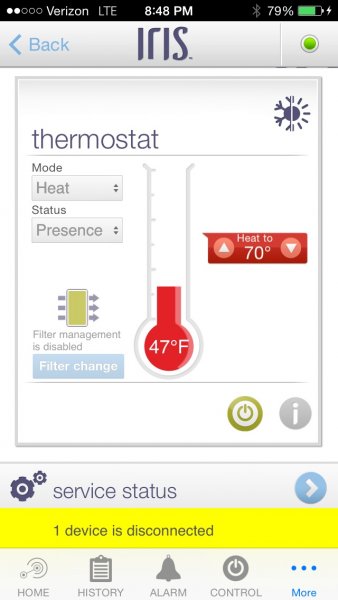

    Thanks Smoke
    Yes
    I currently have a Lowe's Iris millivolt WiFi T-Stat on my Quad Contour!
    It works great and the lowes Iris system gives the most bang for the buck!
    See iphone screen shot below.
