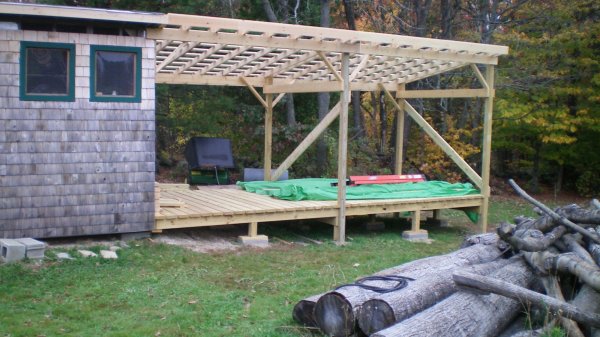

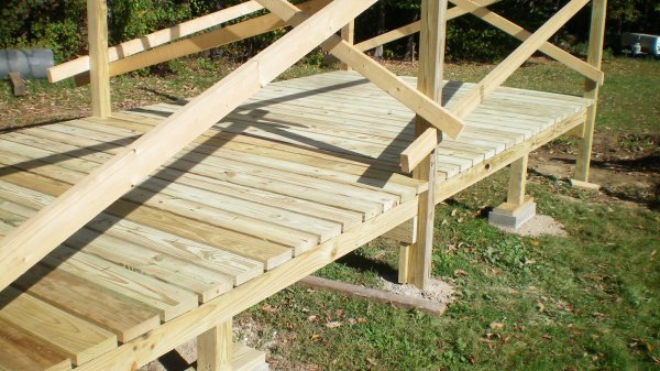

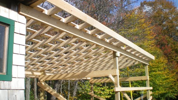

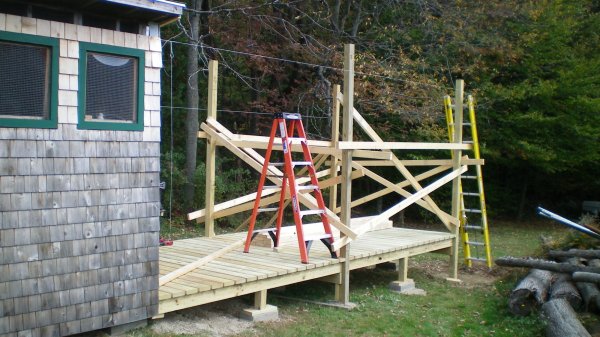

    Not sure mine would be much fun to try and move afterward but here's a few pics... holds around 6 cords. 8x20x6 high at the back.

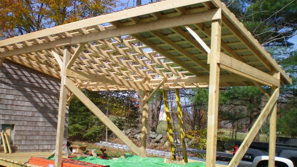

    Here are a couple more portable racks you might be able to make bigger with a roof if you really want to move it later. 4x10x4. And I agree... make it as big as you can afford. You'll use the space.

    The support rails underneath are four - ten foot 4x4s. I would have liked your 3/4 ton tractor cap dragging those out there. Each empty rack must have weighed 500 lbs. My JD could only lift one end.

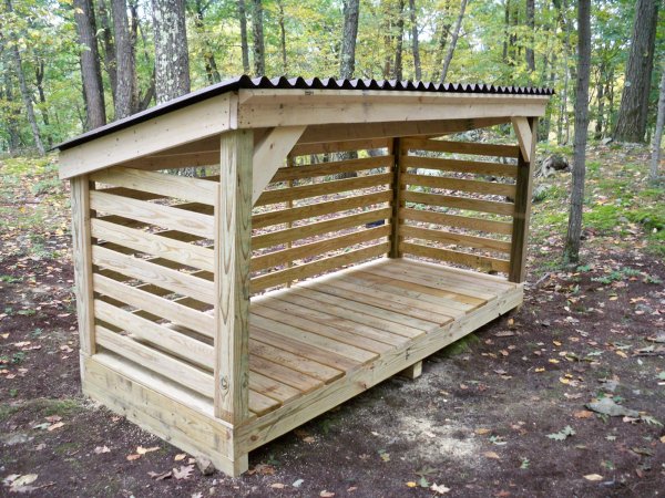

    Using Stinny design, it would be easy to add a roof to them. I've been thinking of building one of these...
    This would easily be adapted to the racks Stinny showed.

    How much wood does one of those hold? With my wood operation moving, I am in the hunt for a different style of wood rack for the front yard.

    The beauty of this design is you can build them to suite your needs, a 8x4x4 would hold a short cord 93% give or take(taking out for end framing) a 10x4x4 would hold 1.18 cord. If you built the base 10x4, with 5' ends, you would have 1.48 cord.... like I said, build to suite your needs.

    It's short of 10' long... I figure it's about a cord with just 2 stacks (20" splits) leaning into themselves at the top (like bogydave) . Little over a cord if stacked tight 16" splits.
