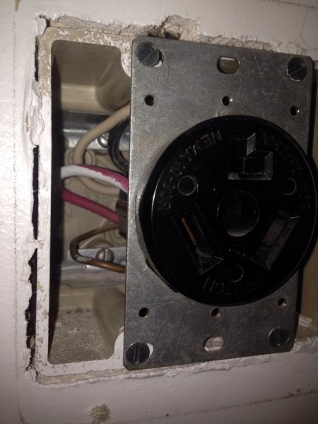

    install a 3 prong 240V receptacle when you already ran the 3 conductor plus ground wire?
    As you can see, I've got two hots, a neutral, and a ground wire in the box. And the ground wire is just hanging out loose in the box. :picard:
    Is there any reason for this other than perhaps he was unable to make the investment in a 4 prong receptacle and appliance cord?

    The previous owner was a union electrician. Which makes it that much stranger but there is a lot of that in this place. So much overkill and there is wire going everywhere here for all kinds of (usually) useful functions. All run fairly neatly, not a rats nest. But then you get down to the finishing details and you have to wonder what his thinking was that day?

    What is that outlet used for?

    Electric Clothes Dryer

    was not code yet.......... saved 20 bucks?? did not want to go to Lowes..... I'll change it tomorrow......heck its safe........no one will know......

    Well he was an electrician. It's like the plumbers faucet that leaks, the mechanics car that's alway broke, carpenters deck that's falling down. You get my drift.worst part is in my humble brain you only need 3 wires for 240. But in line work your neutral is your ground.

    3 wire was legal up until about 10 years ago, then they added the ground.

    Yea I know, but it's still just 3 wires to the house. I always tell people when they ask me about electric. I can get it to your house safely, what it does after that is up to you.

    Then the addition is slightly older than that (1990-something IIRC) but it's still whacky that he ran the ground but didn't use it! :rofl: :lol:
    Knowing what I do about him I'm guessing he wanted to save a few bucks not buying another appliance pigtail and also probably had a 3 wire receptacle lying around a job site somewhere. ;)

    I've fixed two or three in the exact same condition.
    Mine were rental houses so whatever used dryer someone could scrounge up got installed - most people don't know that replacement pigtails are available.
    Usually they wrap it around the screw in the back, but since that looks like a plastic box, wouldn't do anything anyways

    Yup, 4th ground wire was probably installed to ground out a metal box/receptacle plate.

    They can be a little too flexible(for getting receptacles flush/even) and strip out if the box is too full of excess wire(when a deeper gang box is required), metal boxes can strip out as well, you just don't need a drill to oversize for #10 screw in a plastic box:D
    Grounding a metal box is a super fail safe, should a wire come loose, or something builds a nest in it(ants/termites)
    The plastic is enough insulation to prevent the ground path should either occur, so the breaker won't trip and the circuit loses power/nuetral
