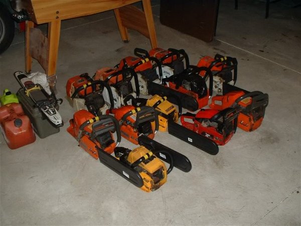

  20. Cut4fun
    Cut4fun
    Mar 18, 2014
    1,941
    3,571
    OHIO Redneck
    All of these were ported but 1. Plus had more that wasnt in pic. Over time you figure out hey it isnt needed to cut firewood. All are sold now.
    All the firewood cutters saws I take care of only want a saw that starts, idles all day and sharp chain. They could care less that their saw is 3-4 seconds slower in a 10 second cut. I have learned the same thing and really liking quieter saws as I have gotten older too.
