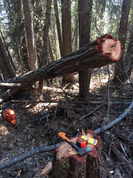

    Welcome to FHC neighbor! zoodayz Larch is my favorite wood. When I drop a larch its always standing dead. Once its down and delimbed I will unzip it as the saying goes. Run your saw down the trunk of the tree so that it breaks through the bark a smidge. Be careful that you don't trip! Once this is done you can commence bucking. I find half of the trees I do this to will have the bark detach on its own once Ive bucked up the tree and some of it has to be manually removed but its normally pretty easy. Doing this in the bush means that you dont have to bring home a mess. I would also suggest that without the bark it will dry quicker. I love finding it as buck skin larch which means standing without any bark at all. Some larch that I have in my stacks has some bark on it still as I don't go to far out of my way to remove it if its being difficult. Larch as you know can have quite thick and gnarly bark and I prefer to fill my stove with wood not splits with inches of bark but that's just personal preference. If I can find a picture of a zipped larch I will post it.

    The first picture is a larch with thick bark that I prefer to de bark. Some larch trees have thin bark that I will just leave on the rounds.

    From what I understand the ones out your way are a bit smaller. Ive never been out your way to observe whether this is true or not. What do you find? The ones in my picture are by no means very big.
