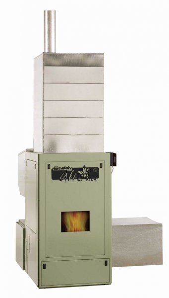

    For the ultimate Pellet furnace...
    http://www.psg-distribution.com/product.aspx?CategoId=28&Id=542
    120,000 BTU's, 6 speed blower (air temp always stays constant, the speed of air is all that changes, 240 lb hope for extended run times 2-5 days (depending on size of house and heat demand/would be around 3 days for me), and can add an electronic element for when pellets tun out, along with Central Air hook up.
    This is one of the 1st all in one furnaces. Unlike all other models that are listed as Secondary units (can NOT have solid fuel as Primary), because of the electric heating elements that are used when pellets run out (removed human error) , this unit can be used as Primary furnace-A/C for a home.
    If and when my Fahrenheit bites the dust? This will be what I buy. It will replace my EVERYTHING. I can sell my Trane LP furnace and A/C condensor and my Fahrenheit. I will likely keep the Enerzone upstairs, just for shoulder season. :) It's a bad Mama Jama
