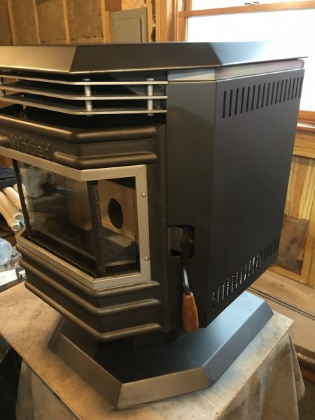

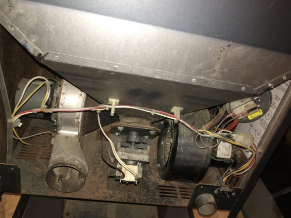

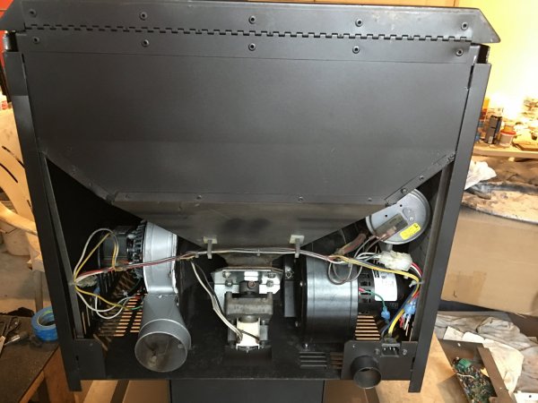

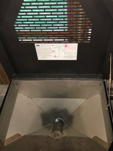

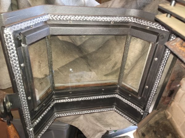

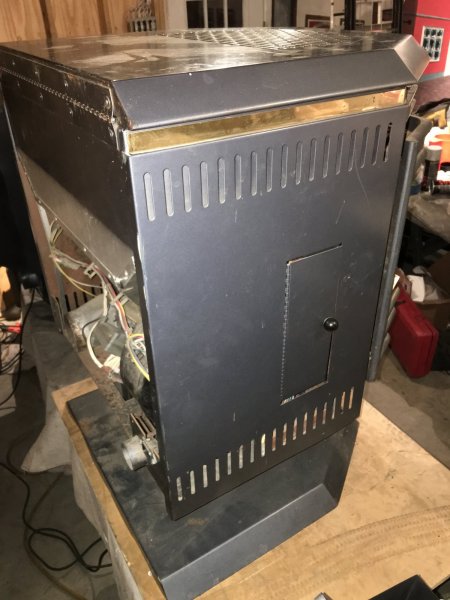

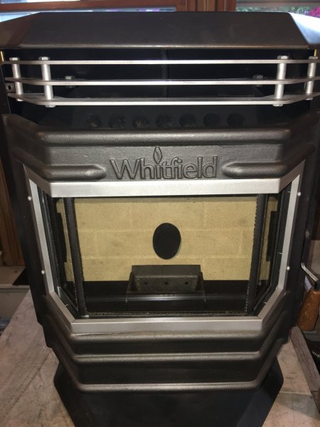

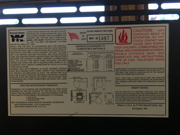

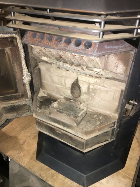

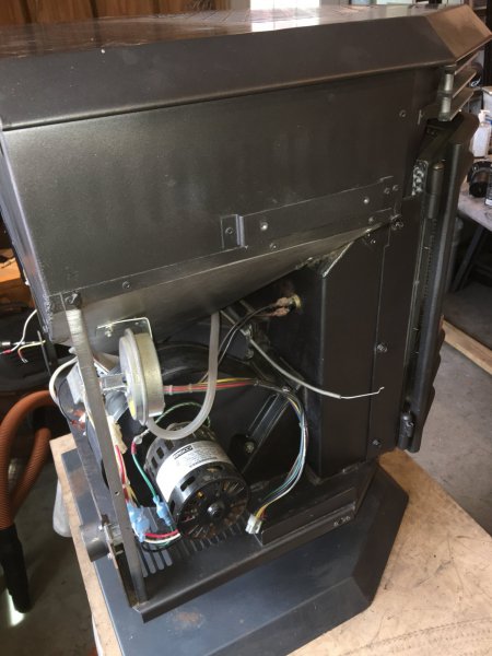

    Snowy did a super job on her Whits so here is my effort. :)
    Found this 1993 Whitfield Quest in decent shape. Everything worked except the circuit board.
    Just gave it a good cleaning, put in new upgraded graphite impregnated door and window gaskets, a new exhaust blower and replaced the old brass auger bearing with the upgraded Nylatron auger bearing. The auger motor works just fine but I can put in a shinny new one if need be. :)
    Then I sprayed 2 coats of Very High Temp VHT flat aluminum with 3 coats of high temp clear on the trim and exhaust housing. Doing all the trim and making it shine took A lot of masking and fussing but the results seem to make it worth it. :)
    I also sprayed high temp charcoal on the body inside and out and Very High Temp Flat black in the Fire Box and ash pan.
    Pics -1 thru -5 are the before pics and pics 0 to 11 are the after pics
    Click pics to enlarge:
