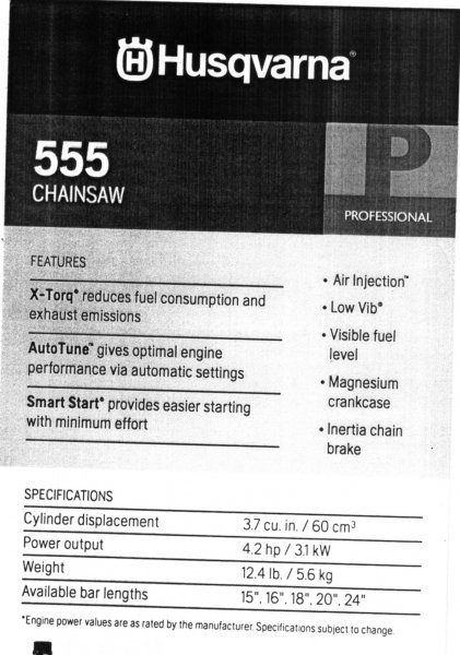

    I'm looking to buy a new saw but Which one?
    The 555 feels nice and light to pick up but will it have the power if it encounters 24" wood?

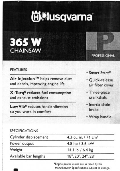

    365W001.jpg The 365 feels heavier to pick up ( 1.7 lbs ) but will definitely have more power for cutting wood in the 2ft diameter.
    For bigger wood I have a 390 with a 36" bar.
    I have thought of putting a 28" bar on the 390 but the mechanic says it could damage the saw by over revving in smaller wood.

    Buy the triple nickel & get it ported. I'm not real up on Husky's, but a good woods port on a 60cc saw will make it feel like 70cc stock. My huskihl ported 036 is a vicious saw. It'll run with a stock 70cc I think & do it well. Just a thought.

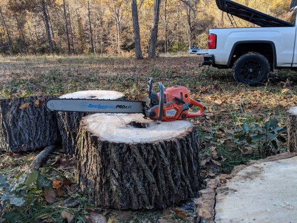

    My 562xp has no problem in 24" hardwood. I can't see where the 555 would be any different.

    Is that a 24" bar on it in the picture?

    Yes it is. Needed it for the last 8 feet of that hickory.

    That's impressive !
