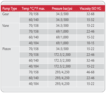

    I'm not real knowledgeable, but here is a chart from Lubriplate.
  5. campinspecter
    campinspecter
    1,683
    12,226
    The chart is helpfull.

    It's really down to the temperatures you'll be using it. Hers a handy dandy chart.
    Most splitters use gear pumps.
