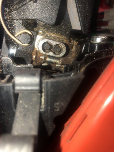

    FBE5258F-5810-45BC-AC63-6FE2376CDC3D.jpeg My Dolmar isn’t very happy at the moment and needs a few adjustments. Anyone know where I can find the tool to turn the mixture screws? I already bought a tach

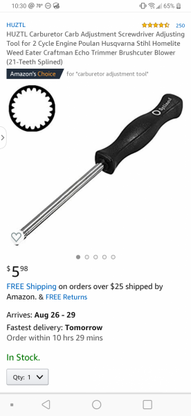

    Screenshot_20190818-104537.png Is it this one?

    The Dolmars use Double D or Single D, depending on the model.
    The kit farmer steve mentioned above should have both.

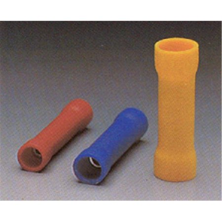

    I saw a hack for adjusting them screws.
    Electrical Insulated Butt Splicers. They come in different sizes. Just shove them over the adjustment screw.
    Your picture looks like the screws on a Poulan and it worked on mine.

    I used them on a crapsman weedwacker the first time I encountered them oddball adjusters.

    That's a great hack...and just for people not familiar, the color denotes the size...but different brands will be a little different on the inside diameter, even in the same size (or color)

    When you get them out with the butt splice, slot cut the ends with your Dremel & a cutoff wheel, then screw buying that Chinese tool.
