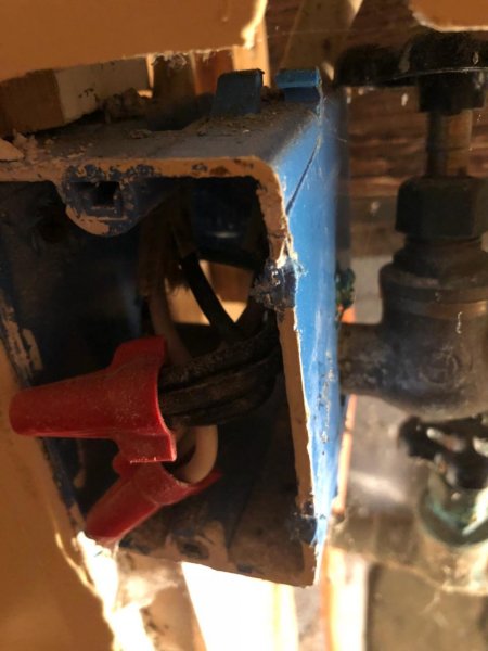

    Okay, as some of you know I'm in a sheetrocking project. A friend of mine who is a good sheetrocker asked me if I could take some time to come help him and he would tape for me. I jumped at the chance, I really dislike sheetrocking. While his little girl (25 lbs) had been jumping in the bathtub, she had broken A fitting and tub sprung a leak. Opened it up was just cheap compression fitting 45 minutes and :yes:..
    Then I saw this :bug::loco: :crazy:
    Can you see it..
    Plumber drilled electrical box for half inch water line. That electrical is 220:faint:

  2. papadave
    So, flip a switch and the water comes on? Turn on the faucet and the light comes on?
    Very 3 stooge-ish.
    WTH???
    I think I've now actually seen everything. Yep.

  3. brenndatomu
    23,426
    150,453
    :hair:
    Slit a piece of PEX lengthwise and slip over the pipe through the box? I know...redneck repair on top of hillbilly install...better than it is now though...

  4. Canadian border VT
    18,249
    119,504
    I did not fix it.. This is a condo. While in my house I would have, I am not licensed or insured against this level of stupidity. Those wires are live. If/when pipe leaks, scary!!

  8. papadave
    220 might be for an in-wall heater. Otherwise......no clue.
    Yeah, pipes can't move, so should go in house before elec, which bends quite easily.

  9. Canadian border VT
    18,249
    119,504
    It goes to an electric heater..
    yooperdave, Eric VW, Chaz and 4 others like this.

  11. Canadian border VT
    18,249
    119,504
    Plumbing first very logical!!
    Drilling through electrical box.. Not so much.. This was an inspected building.. Obviously easiest way to fix is move electrical box.. Just WOW.

  12. papadave
    However, when all you have is a hammer (or drill), everything starts looking like a nail.:picard:

  13. ironpony
    ironpony
    3,564
    18,708
    Mid Ohio
    OK IMO the plumbing was there first and the box was added later, why you ask?
    1) you can see thru the box, it was apparently notched to fit, again why you ask?
    2) it is a new work box with no nails in it and if you enlarge the pic there are drywall screws holding to the stud
    which is notched so the box will miss the valve.
  14. Canadian border VT
    18,249
    119,504
    ironpony yes new work box!! Very possible it was done by worker (I hope not licensed electrician) did that as code mandate placement of boxes.. I was just amazed at stupidity not trying to blame 1 trade or other. I thought ( granted hard to see) it looked as box was drilled.

  15. wildwest
    30,141
    141,336
    Wyoming high plains
    220 could be for a jetted tub or steam shower unit?

  16. ironpony
    ironpony
    3,564
    18,708
    Mid Ohio
    OK so this peaked my curiosity and I did some digging, reading NEC and Googleing , there is no requirements for clearances between electric and plumbing, the only stipulation is no sharp edges.
    They can be in the same hole touching as long as there are no sharp edges. So the electric connection is in a box as required the pipe is run thru the box with no sharp edges.
    As stated the NEC is not there to cover what could happen but for best practices. Would this be recommended? NO but is it illegal? can not find anything that says so.
    HMMM..................
    anyone got anything else?

  17. papadave
    Water and live electricity don't mix well. If that fitting pops, hopefully the breaker will do it's job before any major damage is done.
    Somebody did a goofy thing (illegal or not), and IMHO, one of those should be moved. Go to about the 1:40 mark.............:wacky:

  18. brenndatomu
    23,426
    150,453
    Those new work electrical boxes aren't gonna keep water out of there if the pipe pops anyways...in my mind it is just about one more layer of non conductive material between the dry juice, and the wet juice...

  19. Canadian border VT
    18,249
    119,504
    I agree, I am not a master, gramps was, if I had done this, I would have been ummm 'educated'
    IME, most pipes on inside walls, joints leak before pipes burst.
