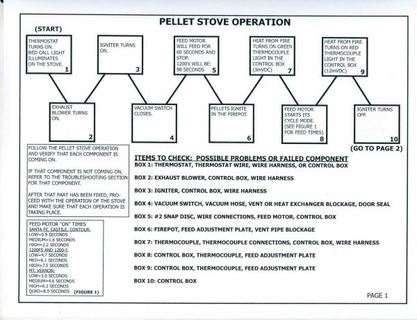

    The Santa Fe and Castile are not so bad because of being lower BTU (don't feed as much), but the CB 1200 can make a HUGE fire on a hot start.
    I don't recommend anyone trying it on purpose, but of the stove is shutting down and you retort it within a few minutes of being off, you'll see the problem I speak of. Thus the reason I always recommend a large swing for this stove. 3° minimum. Unless your stove is off for a fair amount of time after the combustion blower is done with its cleaning cycle.
    Here are the papers that show the steps of start up. If your stove still has a red light (see step 9) on the control board, and it's starting up? Then the thermocouple is still over 250° (remember that burn pot is cast iron and the thermocouple is in a ceramic cover that retains a lot of heat as well).

    what are the diagnostic trees you posted for???? what model?

    Look lower left on 1st page. It's for Castile, Santa Fe and 1200. The 1200 has a longer feed cycle (98 seconds over the 60 of the smaller BTU stoves). Only these 3 Quad stoves.
    Even by the end of step 20 (end of heating cycle). It says stove is ready for another call for heat. But watch the light on the control box at start up on a hot start. Instead of feeding the required 98 seconds of pellets at start up, the stove will not stop at 98 because the thermocouple is still above 250°. So it just goes right into feeding pellets (which is step 8. Instead of waiting for the ignition of pellets). So you end up with a whole lot of pellets in the pot once the ignitor does light off the pellets.
    Hope this explains better. It's been a known issue for Quads for some time. So long as you let it cool properly? There is never an issue or worry.

    i see it now .....is that for the E-2 also??

    Nope. Only the 3 Quads listed. Quads use a thermocouple. Many other stoves dont. They just use snap discs to sense fire.
    It's a good guideline for a lot of stoves, but not an exact guideline.
    For the Castile, Santa Fe, and Classic Bay it's the best troubleshooting tool you'll find. I suggest anyone with test stoves to save those 2 attachments or bookmark this page to help in the future.
